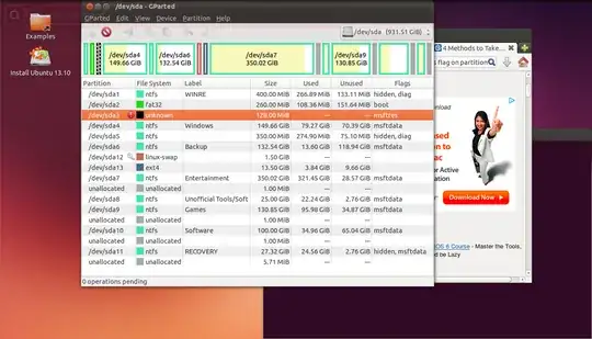

EDIT 1: FYI I just switched to Ubuntu LiveCD to check my Installation and found out that one of my partition is flagged as msftres. Here is a screenshot of my GParted on a LiveCD: Gparted on LiveCD

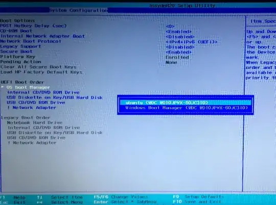

If that doesn't work try to change the boot manager in the BIOS/UEFI settings. Enter the BIOS setup utility -> select System Configuration tab -> OS Boot Manager -> Ubuntu -> press the appropriate key (e.g. F10 Save and Exit) to save the changed settings and exit.
OS Boot Manager
