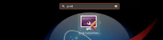

  2. Press the Windows key, search for "grub" and open Grub Customizer.
    Open Grub Customizer

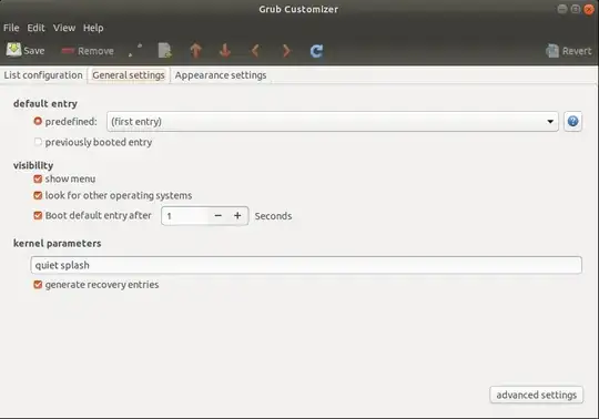

  3. Go to General settings, then check Boot default entry after and change the timer as you want. Here, my timer is 1 seconds.
    Grub Customizer settings
  4. Click on Save, then reboot your system and, congrats, it's working.

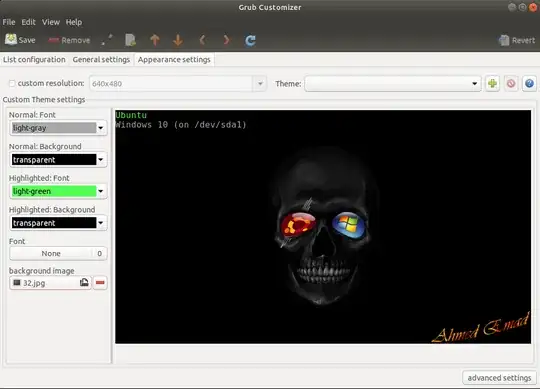

  1. If you want to change background, font size, color or anything related to appearance, then Go to Appearance settings. Here is how my GRUB looks:
    Customized GRUB
