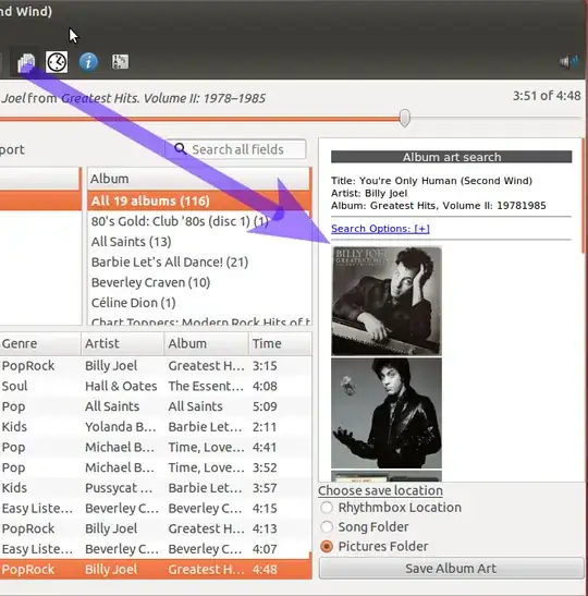

Album Art Search (v2.96 - v3.0+)
Searches the web for the album art of the currently playing song using Google image search APIs. From the resulting images, one can then choose an image to set as album art.
This plugin searches Google for album art. It allows to to select the cover-art for the playing sound-track. You have the option to save a picture in
  • the internal database rhythmbox coverart folder (Rhythmbox Location)
  • the actual song filesystem folder (Song Folder)
  • the users home pictures folder (Pictures Folder)
to install: sudo apt-get install rhythmbox-plugin-albumartsearch
Start Rhythmbox, enable the Album Art Search Panel plugin
tip - disable the Context Pane so that you can display all your album art in the right-hand pane.

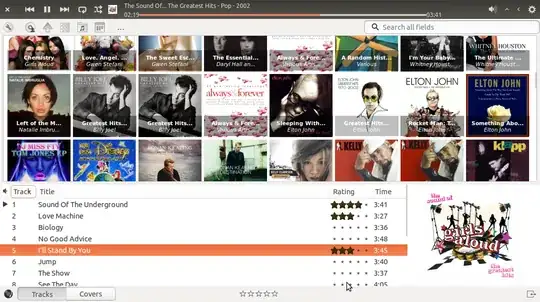

CoverArt Browser (v2.96 - v3.0+)
Imgur
Browse your albums using the cover-art stored with your album.
to install: sudo apt-get install rhythmbox-plugin-coverart-browser
Start Rhythmbox, enable the CoverArt-browser plugin

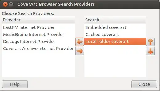

CoverArt Search Providers (v2.96 - v3.0+)
pic
Drop in replacement for the default ArtSearch plugin. This plugin allows you to control where you get your coverart from as well as having more internet search providers to search from. It also has many bug-fixes that the default ArtSearch plugin does not contain.
This works standalone or is combination with v0.8 & later of Coverart Browser
to install: sudo apt-get install rhythmbox-plugin-coverart-search
Start Rhythmbox, enable the Coverart Search Providers plugin

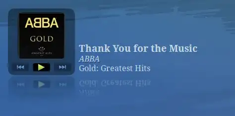

Desktop Art (v2.96 - v3.0+)
Imgur
... and on mouse-over...
Imgur
This applet allows you to display the coverart for tracks & albums and control rhythmbox from your desktop
to install: sudo apt-get install rhythmbox-plugin-desktopart
Start Rhythmbox, enable the Desktop Art plugin

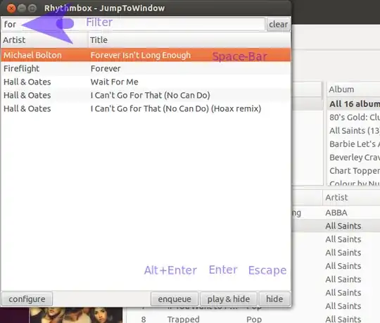

Jump-To-Window (v2.96 - v3.0+)
This applet allows you to play, search, enqueue using the keyboard
It's very similar to the 'Jump to File' feature in Winamp, including the ability to enqueue a song.
It doesnt matter if Rhythmbox has focus or not - the global hotkey you define launches a window allowing you to add songs to the play queue.
To see this in action - fire-up rhythmbox, enable the plugin and press Shift+Ctrl+J to see this in action.
to install: sudo apt-get install rhythmbox-plugin-jumptowindow
Start Rhythmbox, enable the JumpToWindow plugin
to define the global hotkey
/usr/lib/rhythmbox/plugins/JumpToWindow/src/activate.py
For gnome go to System -> Preferences -> Keyboard Shortcuts -> Add and add the above command.
Use whatever keyboard combination you want e.g. CTRL+G, play a song in Rhythmbox and use CTRL+G to launch the JumpToWindow

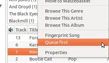

lastfm-extension (v2.96 - v2.98)
Add some LastFM related functionality to Rhythmbox: love/ban buttons, playcount sync and loved tracks sync.
Also available is the ability to finger-print a song i.e. find the track-details for a song based upon the audio in the track.
to install: sudo apt-get install rhythmbox-plugin-lastfm-extension
Start Rhythmbox, enable the lastfm extension plugin

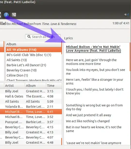

lLyrics (v2.96 - v3.0+)
Displays lyrics for the current playing song in the right sidebar.
This plugin searches and displays the lyrics for the currently playing song. You can also manually find lyrics for any song in your database.
This plugin is useful for those people where the inbuilt plugin does not work.
to install: sudo apt-get install rhythmbox-plugin-llyrics
Start Rhythmbox, enable the lLyrics plugin
Then restart Rhythmbox for the toolbar button to become visible.
tip 1 - disable the Context Pane so that you can display all your lyrics in the right-hand pane.
tip 2 - look for the lyrics menu option (global menu in Unity) for many more Lyrics options and functionality

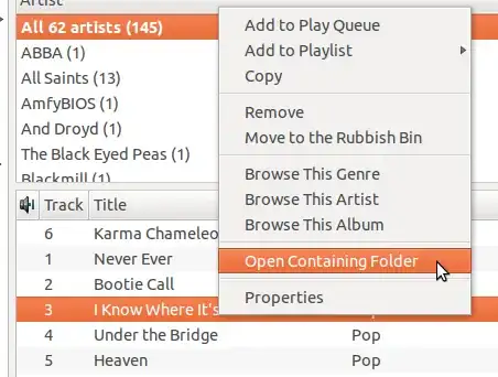

Open Containing Folder (v2.96 - v3.0+)
Adds an option to open the folder containing the selected track(s) to the right click context menu
This plugin allows you to find the folder for the selected music track.
to install: sudo apt-get install rhythmbox-plugin-opencontainingfolder
Start Rhythmbox, enable the Open Containing Folder plugin

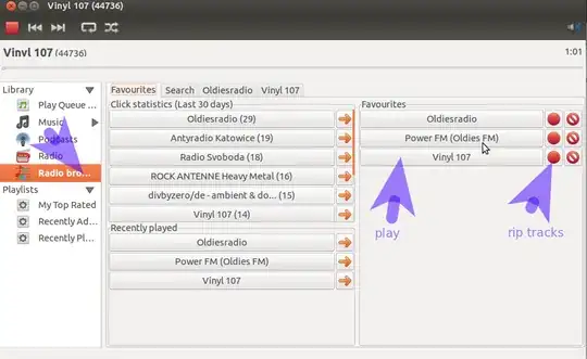

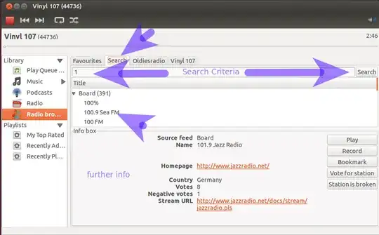

Radio-Browser (v2.96 - v3.0+)
Find internet radio stations and rip tracks
This plugin allows you to search the internet for radio-stations. Once found you have the ability to rip the tracks being played as MP3 files.
to install: sudo apt-get install rhythmbox-plugin-radio-browser
Start Rhythmbox, enable the Internet Radio Station Browser plugin

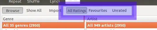

Rating Filters (v2.96 - v3.0+)
pic2
This plugin allows you to filter your default Library source by Ratings.
to install: sudo apt-get install rhythmbox-plugin-rating-filters
Start Rhythmbox, enable the Rating Filters plugin

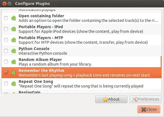

Remember-the-Rhythm (v2.96 - v3.0+)
Plugin to remember the last playing song, source (radio station, playlist), browser values (genre, album, artist)
This is a very useful plugin - when you next start Rhythmbox, it will continue playing the last song that was last playing before Rhythmbox was closed.
to install: sudo apt-get install rhythmbox-plugin-remembertherhythm
Start Rhythmbox, enable the Remember The Rhythm plugin
Note - when you enable the plugin, Rhythmbox will close unexpectedly. Don't worry. Next time subsequently restart, the plugin will be enabled and will continue to work.

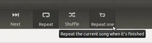

Repeat One Song (v2.96 - v3.0+)
"Repeat one song" feature for Rhythmbox
Adds a toolbar option to repeat the selected track when the toolbar option is clicked. Note - it does not repeat a song from the Play Queue.
to install: sudo apt-get install rhythmbox-plugin-repeat-one-song
Start Rhythmbox, enable the Repeat One Song plugin

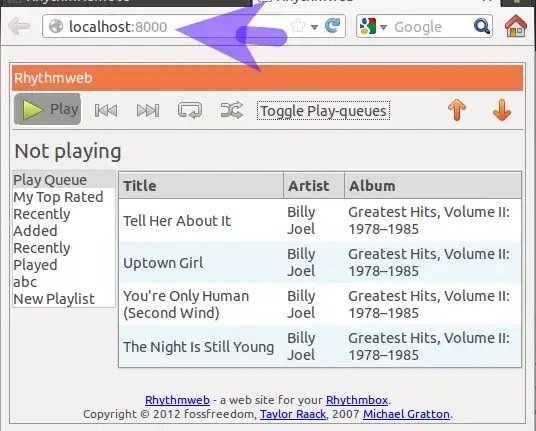

Rhythmweb (v2.96 - v3.0+)
Control Rhythmbox from virtually any internet-browser enabled device - from IPod, Android, MS Windows etc
to install: sudo apt-get install rhythmbox-plugin-rhythmweb
Start Rhythmbox, enable the Rhythmweb plugin, then start your internet-browser enabled device and browse to the PC IP address that rhythmbox is running on - suffix the URL with :8000

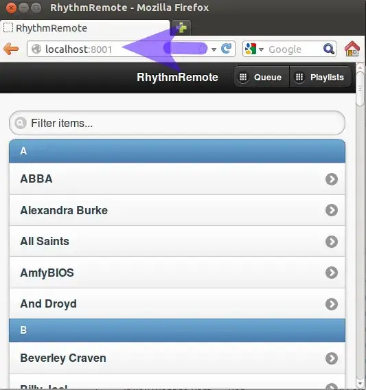

Rhythmremote (v2.96 - v2.99)
Control Rhythmbox from virtually an internet-browser such as Firefox
to install (64bit users only): sudo apt-get install rhythmbox-plugin-rhythmremote
Start Rhythmbox, enable the Rhythmremote plugin, then start your internet-browser enabled device and browse to the PC IP address that rhythmbox is running on - suffix the URL with :8001

Send-First (v2.96 - v2.99)
Small but useful plugin that allows you to send a track or groups of tracks to the beginning of the play-queue rather than the default which is queuing at the end of the play queue.
to install: sudo apt-get install rhythmbox-plugin-send-first
Start Rhythmbox, enable the Send-first plugin

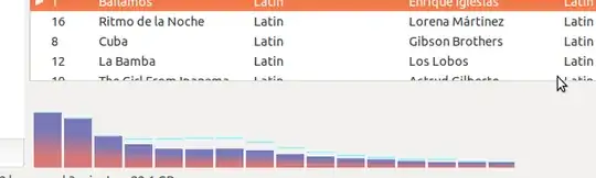

Spectrum (v3.0+)
Adds a visual music spectrum to rhythmbox
to install: sudo apt-get install rhythmbox-plugin-spectrum
Start Rhythmbox, enable the Spectrum plugin and use CTRL+S to start or hide the spectrum

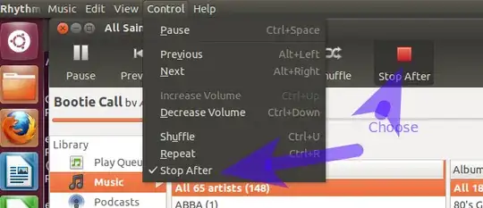

Stop After Current Track (v2.96 - v2.98)
This is a plugin for Rhythmbox, which adds an option to stop playback after current track.
Useful where you do not want the music to stop abruptly but you do not want to wait until the current playlist finishes
to install: sudo apt-get install rhythmbox-plugin-stopafter
Start Rhythmbox, enable the Stop After Current Track plugin

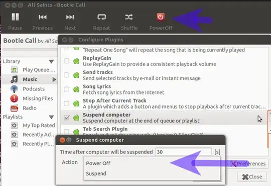

Suspend PC (v2.96 - v3.0+)
Suspend computer at the end of queue or playlist
Use the plugin preferences to set the timeout and also whether to shutdown (default) or to suspend your computer
to install: sudo apt-get install rhythmbox-plugin-suspend
Start Rhythmbox, enable the Suspend plugin

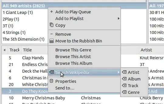

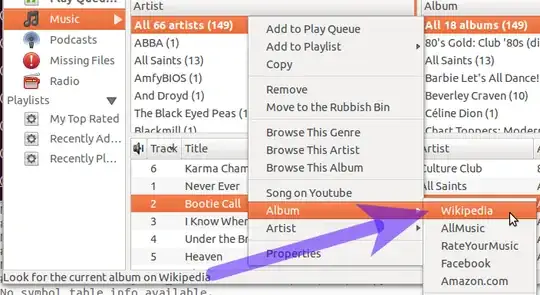

Wikipedia (v2.96 - v3.0+)
pic
Search for selected artist, album, track or genre at the click of a button.
By right-clicking a track, you can search Wikipedia for details about the track. This will open your default browser with the associated Wikipedia page (if available).
to install: sudo apt-get install rhythmbox-plugin-wikipedia
Start Rhythmbox, enable the Wikipedia Search plugin
