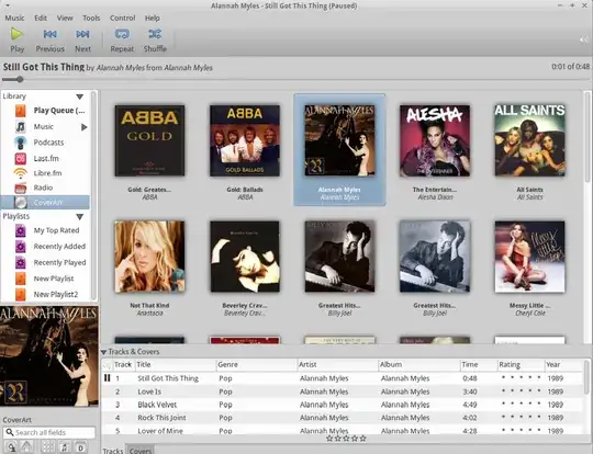

Browse your coverart albums in Rhythmbox v2.96 and later
Imgur
first the disclaimer - I am the co-author to this plugin!
How it works:
  • Click the new CoverArt source button (left hand side of screen)
  • Albums are displayed as clickable buttons containing their album cover

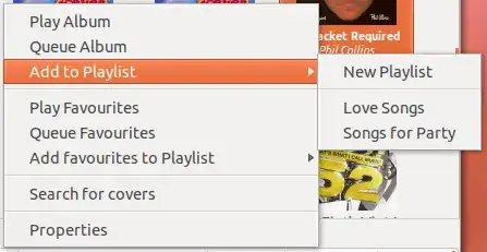

  • Right click menu option to play, queue & search for cover art for an album.

  • to search for missing covers
