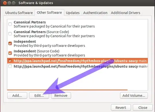

Rhythmbox 3.0 on Saucy
If you are a saucy user and have Rhythmbox 3.0 installed via either my PPA or Jacobs PPA then you'll need to edit your sources from saucy to trusty

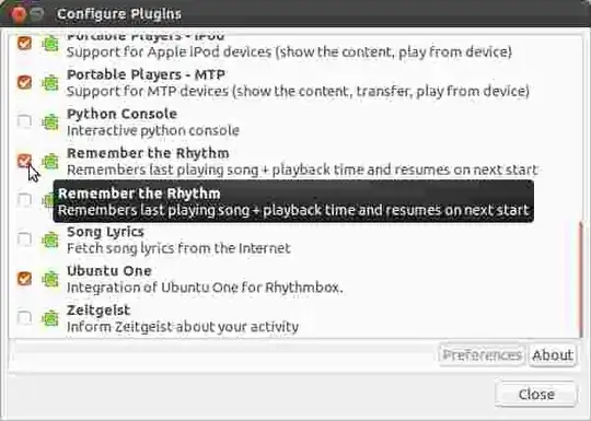

You need a plugin like Remember The Rhythm which will remember the last playing song and playback time, source (radio station, playlist), browser values (genre, album, artist).
To install Remember The Rhythm you can use the following commands in terminal if you use Ubuntu 12.04 (Precise Pangolin):
sudo add-apt-repository ppa:loneowais/ppa
sudo apt-get update
sudo apt-get install remember-the-rhythm
If you use a newest Ubuntu version than 12.04, then you must to install it manually:
  • Download the zip package.
  • Unzip the remember-the-rhythm-master.zip file:
    unzip /path/to/remember-the-rhythm-master.zip -d /path/to/extract
  • Install Remember The Rhythm:
    cd /path/to/extract/remember-the-rhythm-master
    sudo make install
After you install it with success, open Rhythmbox player, go to RhythmboxPlugins and enable Remember the Rhythm plugin:
