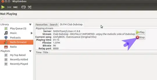

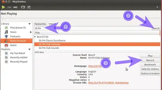

Finally, launch Rhythmbox, activate the global menu (move your mouse to the top of the screen) - Edit - Plugins - Internet Radio Station Browser
