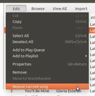

Repeat One Song (Rhythmbox versions v2.99 and later)
For v2.99 and later the "Repeat one" button is replaced by the source "Edit - Repeat Current Song" menu option
