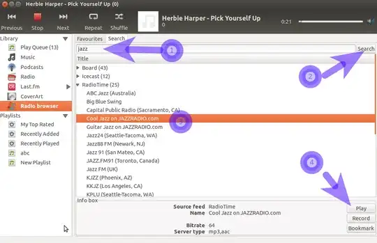

The RadioBrowser plugin could be useful if you like to browse for new radio stations.
You mentioned Jazz...
There are several jazz radio-stations as shown in the picture.
More information in the links below
installation instructions
sudo add-apt-repository ppa:fossfreedom/rhythmbox-plugins
sudo apt-get update
sudo apt-get install rhythmbox-plugin-radio-browser
then start rhythmbox and select the menu edit-plugins, tick the checkbox internet radio station browser

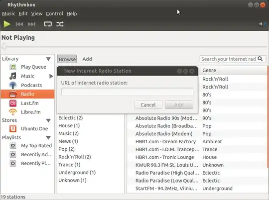

Open Rythmbox, on the side panel, under library select Radio. Then click on the Add button.
It will open a place for you to type the URL of the internet radio station you like. enter image description here
