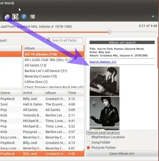

I want to install Album Art Search in the Rhythmbox.
Like this

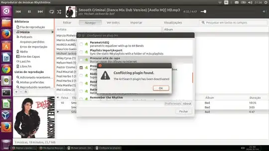

But when I select the plug-in appear for me error:
Conflicting plugin found. The ArtSearch plugin has been deactivated
See the pic here

The plugin you mentioned is actually called AlbumArtSearch and is available through the package rhythmbox-plugin-albumartsearch.
The above package is only available for Rhythmbox v2.96 to v2.98 users. Unfortunately the author - nor anybody else has forked the project to maintain it for later v2.99 & v3.0+ users - hence it is not in the PPA in question.

The conflicting message is because you were actually trying to re-enable the default Rhythmbox plugin called CoverArt Search. This plugin is superseded by the CoverArt Search Providers plugin that you have installed instead - the same functionality and more is available through CoverArt Search Providers.

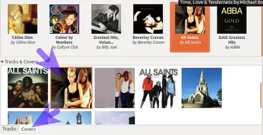

Lastly - you might like to know that part of the Album Art Search functionality was actually incorporated into my plugin CoverArt Browser - just click on the album and the covers from Google are displayed in the Covers tab.
