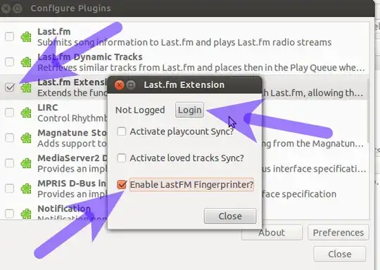

Once installed, enable the plugin and click the Preferences button

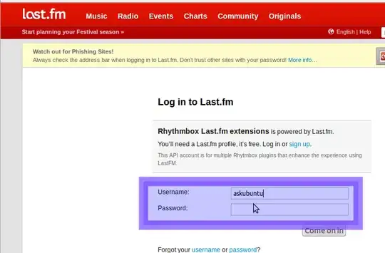

Tick the checkbox shown above and click the Login button. This will fire-up your favourite browser.
Login to LastFM:

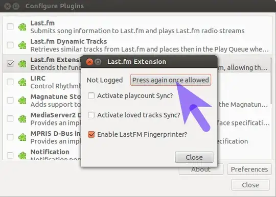

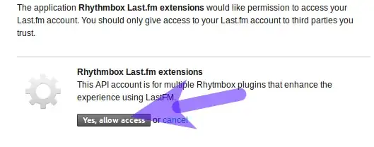

Then allow the plugin access to LastFM:
Finally, click the button shown to finish the Rhythmbox configuration:

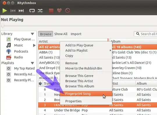

How to finger print a song
You will now have a new right-click option that searches LastFM:

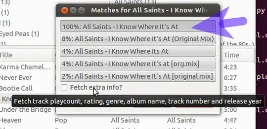

When it finds possible matches, it presents this in most-likely order:
By default, it will update the artist, album and title of the song.
There is an extra check-box which does a deeper search of LastFM to find additional information about your song.
