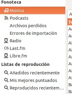

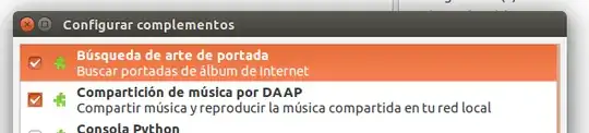

I am unable to browse by cover art in Rhythmbox. Apparently plugin is installed and active but I don't see the left pane option "Browse by cover art"
EDIT: I can't install cover browser for some reason:

The key error message is this part:
(rhythmbox:9231): libpeas-WARNING **: Could not find loader 'python' for plugin 'coverart_search_providers'
What this means is that you are using a python 2 plugin rather than the python 3 plugin that Rhythmbox v3.x requires.
Looking at the README there is a section specifically about how to install the plugin coverart-search-providers for Rhythmbox 3.
I've narrowed down the instructions specifically for Ubuntu & derivatives for Ubuntu 14.04 and later
How to install - Rhythmbox 3.0 and later:
for debian and other debian derived distros (such as ubuntu 14.04 & Mint based on 14.04):
sudo apt-get install git gettext python3-mako python3-requests python3-gdbm python3-pil python3-lxml
rm -rf ~/.local/share/rhythmbox/plugins/coverart_search_providers
git clone https://github.com/fossfreedom/coverart-search-providers.git
cd coverart-search-providers
./install.sh
The plugin requires either python3-mutagen (v1.25 or later) or mutagenx (v1.24 or later), both of which are available from PyPi
Alternatively, from GitHub
Mutagenx is Debian packaged from the PPA:
Finally there is one more method to install this and other rhythmbox plugins - just install from PPA which will install all the prerequistites including mutagen as well:
install the package rhythmbox-plugin-coverart-search
