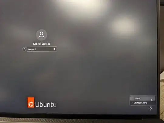

  2. At the login screen, click your username to begin typing your password.
  3. This enables a little gear icon in the bottom-right, to select your window manager. Click that to select your window manager. Choose the non-Wayland option!
    If currently set to the Wayland option, then it will show "Ubuntu" [which means Wayland in this case] and "Ubuntu on Xorg" [which means X11]. Choose the "Ubuntu on Xorg" option. Here are some screenshots:
    Again, if it shows "Ubuntu" and "Ubuntu on Xorg", choose "Ubuntu on Xorg":

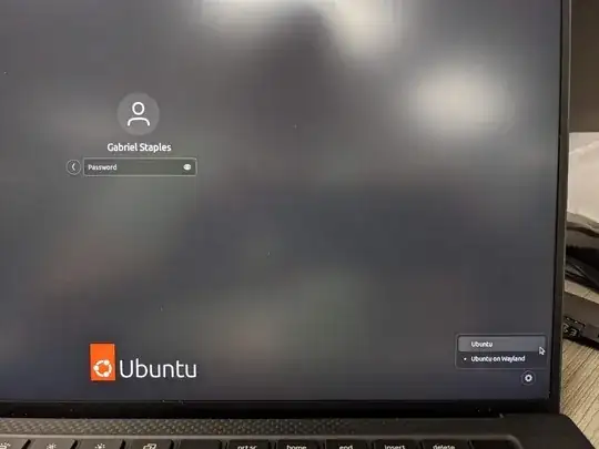

    But if you are in X11, then it will show "Ubuntu" [X11] and "Ubuntu on Wayland" [Wayland].
    So, if it shows "Ubuntu" and "Ubuntu on Wayland", then choose "Ubuntu":

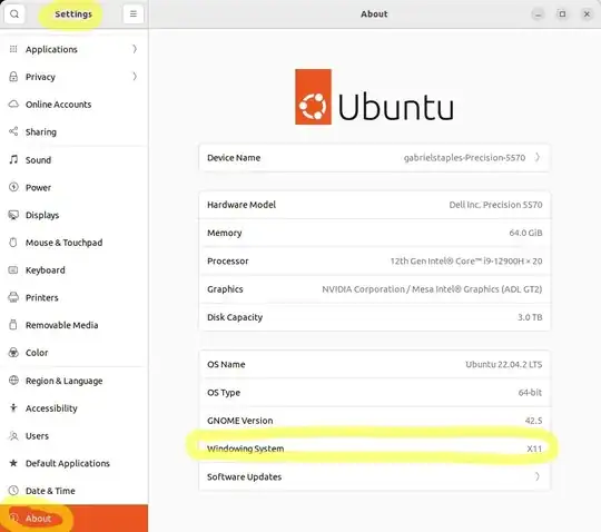

  4. Once you are logged in, you can see which window manager is active by going to Ubuntu Settings --> About --> Windowing System, as shown below. I am logged in with the X11 window manager here, as you can see:
