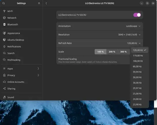

In my case I had a USB-C hub connected to my Dell XPS 15 9570, running X11 on Ubuntu 23.04. All kinds of peripherals were connected there, including my external 42 inch 4K display (LG C3). Even though the hub supported up to 4K 60Hz I regularly experienced stuttering and flickering graphics - which was really driving me crazy.
After some trial and error with both software (drivers, kernels, display settings) and hardware (using different USB-C ports, different hubs) I could find a working solution.
Solution: Now I'm using a dedicated USB-C to HDMI adapter (Anker) for the external display, which apparently supports even 4K 120Hz.
No flickering, no stuttering - just smooth graphics. Happy me!
