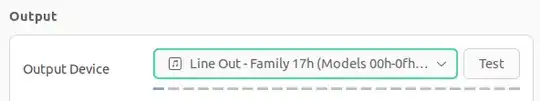

Take a look in Settings...Sound... and see which one is chosen.
Mine only works properly when I have the Line Out Family 17H one chosen.
family 17h sound

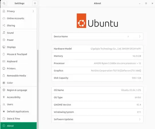

Oh, also, are you running Wayland windowing system? Or area you running X11? I've seen a number of problems with Wayland and when I switched away (to X11) on 22.04 I didn't have any problems after.
Checking Settings...About... Windowing System
x11 system about
Here's how you can change it if you want to : Use X11 instead of Wayland.
