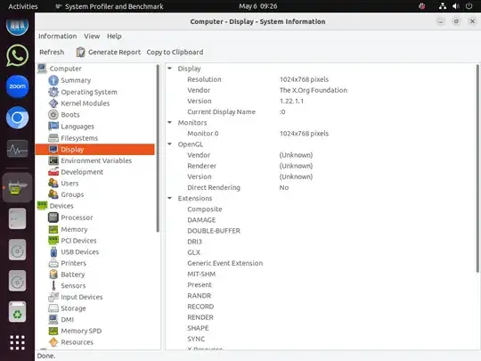

screenshot as:
hardware

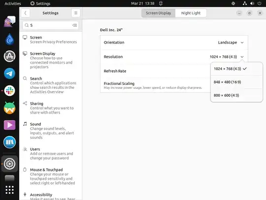

and:
resolution
However, that resolution is woefully low. How is a higher resolution selected?
Previously, rebooting fixed the resolution problem. Now, it's stuck at the "highest" resolution which is far lower than the resolution yesterday.
In the context of generally troubleshooting Wayland, for this given graphics card:
