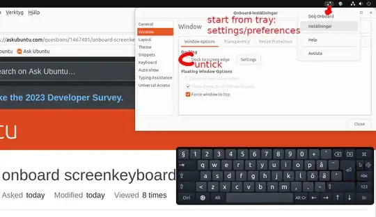

It works for me in Ubuntu Desktop 22.04.2 LTS when using X
I switched from Wayland to X.
See the picture, how to start the Settings/Preferences window from tray, and then untick 'Dock to screen edge'.
Edit the configuration file to switch from Wayland to X:
sudo nano /etc/gdm3/custom.conf
to uncomment [remove # from] the line containing
WaylandEnable=false
save the file (ctrl + x and after that y ('yes') or another key for non-English and finally Enter) and reboot.
