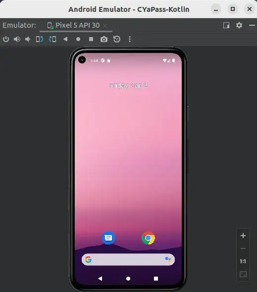

I rebooted and then started up Android Studio. I started the android emulator and it started up as expected.
So glad to be off wayland.
android emulator finally running

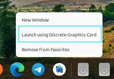

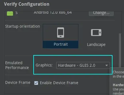

after I installed Nvidia driver, I right click to icon Android studio and ran "Launching using Discrete Graphics Card" and also I changed emulated performance to "Hardware - GLES 2.0" and eventually worked for me
