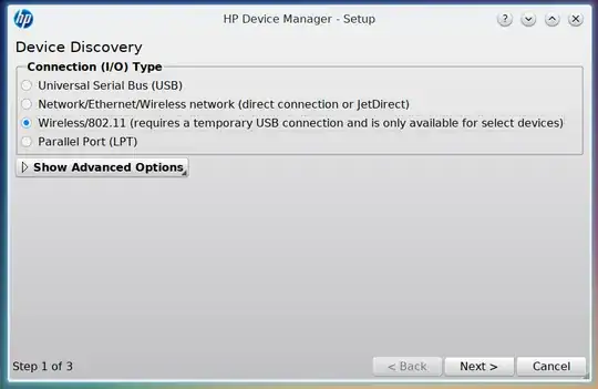

According to official HP documentation we need to have HPLIP installed and then install binary plugin as follows.
To install the plug-in using the GUI you can follow these procedures:
  1. Launch a command-line window and enter:
    hp-setup
  2. Select your connection type and click "Next".
  3. Select your printer from "Selected Devices" list and click "Next".
  4. Enter your root password when prompted and click "Next".
  5. Use the recommended installation method and click "Next".
  6. Check the box to accept with the "Driver Plug-In License Agreement" and click "Next".
  7. Finish the installation of the printer as normal, however you may be prompted to re-enter your user name and password.
