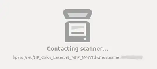

I'd like to use network scanning, too. I'm using hp-toolbox to kick off simple-scan with the correct hpaio scanner URI. Everything works as expected, except for the five minute wait when I click the green "Scan" button. It pauses showing this:
Any ideas on how to speed up this bit?
