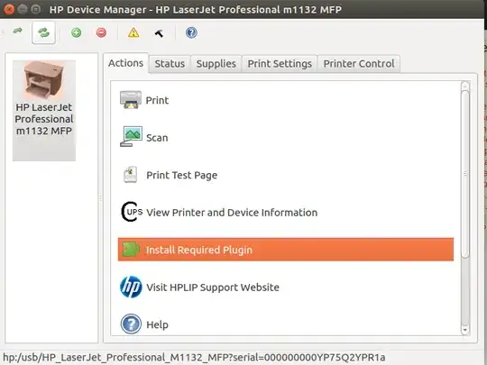

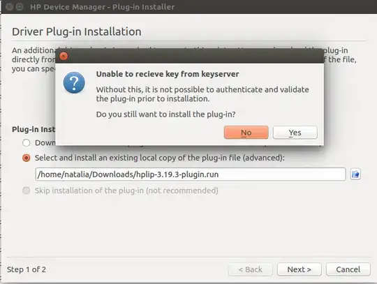

I've installed hplip-3.19.3.run on my Ubuntu 16.04 to use my LaserJet M1132 MFP and the driver was installed, but it keeps asking for an installation of proprietary plugin. I downloaded the plugin from the HP site and passing it through a existing location but the installation always fails:
Unable to receive key from server
Plug-in install failed

I'll write complete explanation here to make things more clear.
Really you do not need binary driver package from HPLIP SourceForge site.
If you have already downloaded, then remove it with and setup MFP with steps below:
  1. Navigate to the folder where hplip-3.19.3.run saved.
    cd ~/Downloads
  2. Remove this HPLIP 3.19.3 from the system if was installed with
    sh hplip-3.19.3.run --noexec
    cd hplip-3.19.3
    sudo ./uninstall.py
    sudo rm -rf /usr/share/hplip/
  3. Then install HPLIP deb-package with APT from the repository:
    sudo add-apt-repository universe
    sudo apt-get install hplip-gui
  4. Launch HPLIP setup
    hp-setup
    and follow wizard steps:
    1. Select your connection type and click "Next".
    2. Select your printer from "Selected Devices" list and click "Next".
    3. Enter your root password when prompted and click "Next".
    4. Use the recommended installation method and click "Next".
    5. Check the box to accept with the "Driver Plug-In License Agreement" and click "Next".
    6. Finish the installation of the printer as normal, however you may be prompted to re-enter your user name and password.
  5. And finally install the HPLIP binary plugin/addon:
    hp-plugin
  6. Enjoy!
