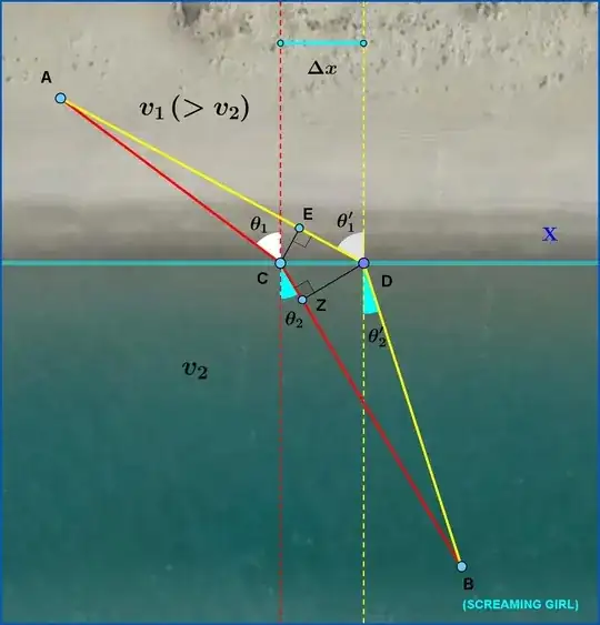

Suppose you are at point A in the land and a screaming girl is at point B in the sea. You can run with a speed $\:v_{1}\:$ on the land greater than the speed $\:v_{2}\:$ you can swim in the sea. At a moment you decide to follow the path ACB spending time $\: t_{1}=AC/v_{1}\:$ running on the land and time $\: t_{2}=CB/ v_{2}\:$ swimming in the sea, that is total time
\begin{equation} t_{tot}=t_{1}+t_{2}=\dfrac{AC}{v_{1}}+\dfrac{CB}{v_{2}} \tag{01} \end{equation}
But after a while you change your mind and decide to displace the point C on shoreline a little to the right to the point D. But then you are wondering if by such a displacement you shorten the total time or not.
For infinitesimally small displacement $\:CD\equiv \Delta x\:$ you can do the following approximations :
\begin{equation} AE \approx AC \qquad \theta_{1}^{\prime} \approx \theta_{1} \qquad BZ \approx BD \qquad \theta_{2}^{\prime} \approx \theta_{2} \tag{02} \end{equation}
You realize that on one hand you decrease the swimming distance by $$ BC-BD \approx CZ=\Delta x \cdot \sin\theta_{2} \tag{03} $$ so changing (decreasing) the swimming time by $$\Delta t_{2}=t_{2}^{\prime}-t_{2}=-\Delta x \cdot \dfrac{\sin\theta_{2}}{v_{2}} \tag{04} $$ On the other hand you increase the running distance by $$ AD-AC \approx DE=\Delta x \cdot \sin\theta_{1} \tag{05} $$ so changing (increasing) the running time by $$\Delta t_{1}=t_{1}^{\prime}-t_{1}=+\Delta x \cdot \dfrac{\sin\theta_{1}}{v_{1}} \tag{06} $$

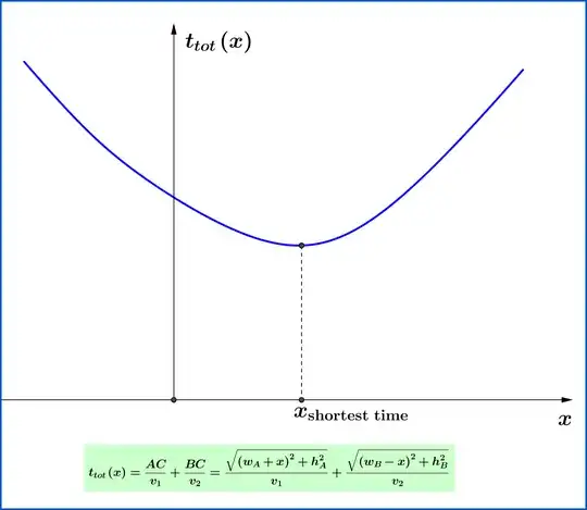

So, balancing, the total time change is $$ \Delta t_{tot}=t_{tot}^{\prime}-t_{tot}=\left(t_{2}^{\prime}+t_{1}^{\prime} \right)-\left(t_{2}+t_{1}\right)=\Delta t_{2}+\Delta t_{1}= \Delta x \cdot\left(\dfrac{\sin\theta_{1}}{v_{1}}- \dfrac{\sin\theta_{2}}{v_{2}}\right) \tag{07} $$ This means that if $$ \left(\dfrac{\sin\theta_{1}}{v_{1}}- \dfrac{\sin\theta_{2}}{v_{2}}\right) > 0 \tag{08} $$ then moving infinitesimally to the right, $\: \Delta x >0 \:$, we increase the time while moving to the left, $\: \Delta x <0 \:$, we decrease the time. So in case that the condition (08) is valid then in order to find a shorter time we must search to the left of point C.
If $$ \left(\dfrac{\sin\theta_{1}}{v_{1}}- \dfrac{\sin\theta_{2}}{v_{2}}\right) < 0 \tag{09} $$ then moving infinitesimally to the right, $\: \Delta x >0 \:$, we decrease the time while moving to the left, $\: \Delta x <0 \:$, we increase the time. So in case that the condition (09) is valid then in order to find a shorter time we must search to the right of point C.
But finally, if $$ \left(\dfrac{\sin\theta_{1}}{v_{1}}- \dfrac{\sin\theta_{2}}{v_{2}}\right) = 0 \tag{10} $$

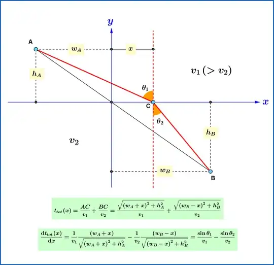

then either moving to the right,$\: \Delta x >0 \:$, or moving to the left , $\: \Delta x <0 \:$, the change is infinitesimally zero. This is the definition of the extreme points of a function. So, condition (10) is the one of the shortest time and if you are a light ray then in terms of refraction indices
$$ v_{1}=c_{1}=\dfrac{c_{0}}{n_{1}}, \quad v_{2}=c_{2}=\dfrac{c_{0}}{n_{2}} \tag{11} $$ and (10) is Snell's Law
$$ \bbox[#FFFF88,12px]{n_{1}\sin\theta_{1}=n_{2}\sin\theta_{2} \qquad \textbf{(Snell's Law)}} \tag{12} $$
