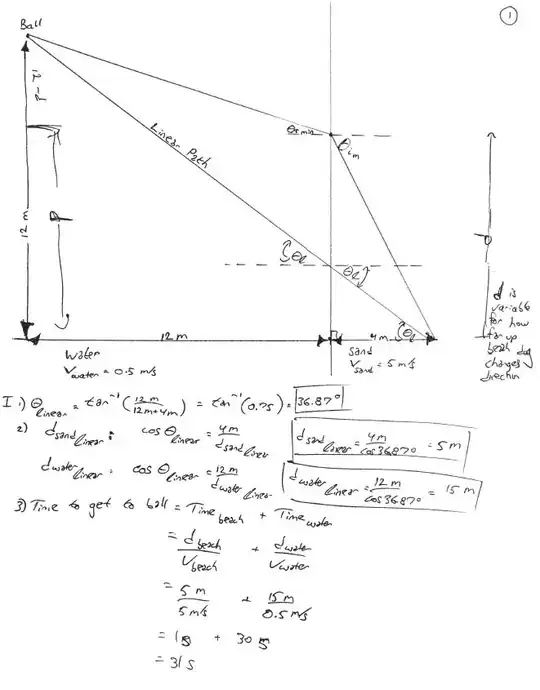

I worked out this problem some time ago and am including a diagram of the main analysis. The first image shows the calculation of the time of transit for the straight path, with speed of the dog on sand (5 m/s) > speed of dog in water (0.5 m/s). The dog is 4 m from the water initially, and the ball is 12 m away from the sand. I made these numbers up. enter image description here

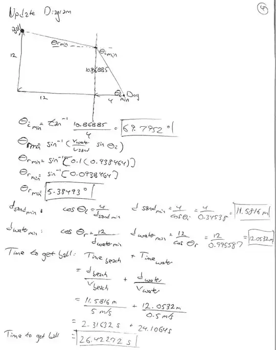

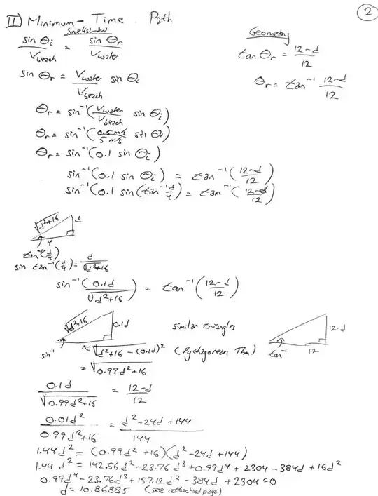

The second images shows the calculation of how far the dog should run on the sand before moving into the water to take the path of minimum transit time. enter image description here

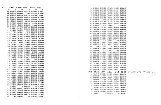

I also include a screen capture of a spreadsheet analysis where I verified that the path calculated has the minimum transit time among many path alternatives that vary among distance d along the sand before entering the water:
