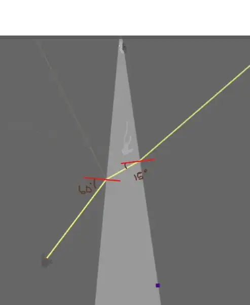

This is what a prism with a normal angle looks like; notice the side of the 15°.
This is what a prism with a normal angle looks like, notice the 15 def

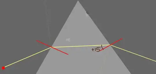

Now consider another prism that is a little thinner. You will notice that the 15° is measured from the OTHER SIDE OF THE RED LINE (normal).
Here is another prism with a smaller angle
This 15° is written as -15° while writing mathematically. So if you get a negative angle as the answer, then how we measure the angle with respect to the normal is reversed.
