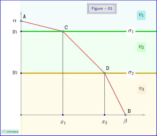

Consider that in Figure 01 above the givens are $v_1,v_2,v_3,\alpha,y_1,y_2,\beta$. The two equations of Snell's Law on the surfaces $\sigma_1\,$ and $\sigma_2$ will give a system with respect to the unknown variables $x_1,x_2$ and identify the points $\texttt C$ and $\texttt D$ respectively.

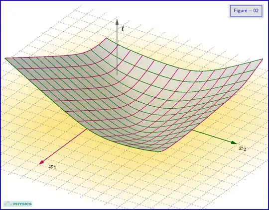

The surface in Figure 02 represents the function $t\plr{x_1,x_2}$ of Equation \eqref{03}. The graticule of $x_1$- and $x_2$-parameter curves is shown on the surface. The drawing was produced with the following data: \begin{equation} \begin{split} \alpha &\e 10 \qquad \beta \e 10\\ y_1 &\e 7 \qquad y_2 \e 4\\ v_1 &\e 5 \qquad v_2 \e 4 \qquad v_3 \e 3\\ x_1 &\bl\in \blr{-5,21} \qquad x_2 \bl\in \blr{-5,21} \end{split} \tl{05} \end{equation} Note that the solution with respect to $x_1,x_2$ depends on the ratios of the speeds and not on their values. For example, instead of the speeds in \eqref{05}, we could equivalently have used the following refraction indices:

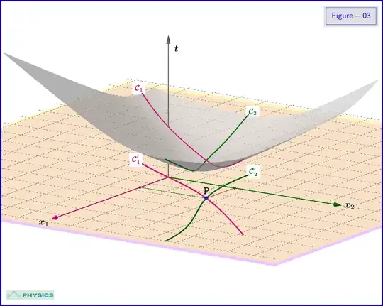

In Figure 03 the two curves $\mathcal C_1$ and $\mathcal C_2$ on the surface are the geometrical loci of the minimum with respect to $t$ of the $\,x_1$- and $\,x_2$-parameter curves respectively. Their projections $\mathcal C'_{\,\!1}$ and $\mathcal C'_{\,\!2}$ on the $\,x_1x_2$-plane intersect at a point $\texttt P$, the coordinates of which are the solution $(x_1,x_2)$ of the system of Equations \eqref{04.1}-\eqref{04.2}.

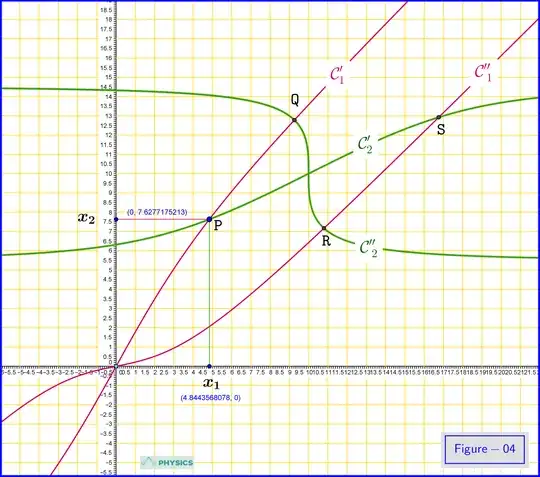

Squaring the Snell's Law equations \eqref{04.1} and \eqref{04.2} the pair of unknowns $(x_1,x_2)$ must satisfy the following non-linear system: \begin{align} v^2_2x^2_1\left[\plr{x_2\m x_1}^2\p \plr{y_2\m y_1}^2\vp\right]\m v^2_1\plr{x_2\m x_1}^2\left[x^2_1\p \plr{\alpha\m y_1}^2\vp\right] &\e0 \tl{07.1}\\ \!\!\!\!\!\!\!\!\!\!\!\!\!\!v^2_3\plr{x_2\m x_1}^2\left[\plr{\beta\m x_2}^2\p y^2_2\vp\right]\m v^2_2\plr{\beta\m x_2}^2\left[\plr{x_2\m x_1}^2\p \plr{y_2\m y_1}^2\vp\right]&\e0 \tl{07.2} \end{align} After inserting the data of \eqref{05}, these equations are represented by the curves on the $x_1x_2$-plane shown in Figure 04. More precisely, Equation \eqref{07.1} is represented by the two-branch curve $\mathcal C'_{\,\!1}\bl\cup\mathcal C''_{\,\!1}$, while Equation \eqref{07.2} is represented by the two-branch curve $\mathcal C'_{\,\!2}\bl\cup\mathcal C''_{\,\!2}$.
The branches $\mathcal C'_{\,\!1}$ and $\mathcal C'_{\,\!2}$ are accepted while the branches $\mathcal C''_{\,\!1}$ and $\mathcal C''_{\,\!2}$ are rejected based on the following reasoning.
Equation \eqref{04.1} is identical with the Snell's Law at point $\texttt C$ in Figure 01: \begin{equation} n_1\sin\theta_1\plr{x_1,x_2}\e n_2\sin\theta_2\plr{x_1,x_2} \tl{08} \end{equation} Equation \eqref{07.1} is equivalent to the square of Equation \eqref{08}: \begin{equation} n^2_1\sin^2\theta_1\plr{x_1,x_2}\e n^2_2\sin^2\theta_2\plr{x_1,x_2} \tl{09} \end{equation} On the one hand, the solution pairs $(x_1,x_2)$ of Equation \eqref{09} represented by the branch $\mathcal C'_{\,\!1}$ satisfy \eqref{08} and are accepted. On the other hand, those represented by the branch $\mathcal C''_{\,\!1}$ satisfy Equation \eqref{10} below and are rejected.
\begin{equation} n_1\sin\theta_1\plr{x_1,x_2}\e \m n_2\sin\theta_2\plr{x_1,x_2} \tl{10} \end{equation} Similarly, Equation \eqref{04.2} is identical with the Snell's Law at point $\texttt D\,$ in Figure 01: \begin{equation} n_2\sin\theta_2\plr{x_1,x_2}\e n_3\sin\theta_3\plr{x_1,x_2} \tl{11} \end{equation} Equation \eqref{07.2} is equivalent to the square of Equation \eqref{11}: \begin{equation} n^2_2\sin^2\theta_2\plr{x_1,x_2}\e n^2_3\sin^2\theta_3\plr{x_1,x_2} \tl{12} \end{equation} On the one hand, the solution pairs $(x_1,x_2)$ of Equation \eqref{12} represented by the branch $\mathcal C'_{\,\!2}$ satisfy Equation \eqref{11} and are accepted. On the other hand, those represented by the branch $\mathcal C''_{\,\!2}$ satisfy \eqref{13} below and are rejected.
\begin{equation} n_2\sin\theta_2\plr{x_1,x_2}\e \m n_3\sin\theta_3\plr{x_1,x_2} \tl{13} \end{equation}
So, the solution pair $(x_1,x_2)$ is found as the coordinates of the point $\texttt P\equiv \mathcal C'_{\,\!1}\bl\cap\mathcal C'_{\,\!2}$. Note that the implicit curves $\mathcal C'_{\,\!1},\mathcal C'_{\,\!2}$ and their intersection point $\texttt P$ of Figure 04 are also shown in the $x_1x_2$-plane of Figure 03.

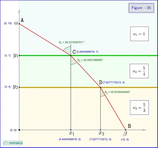

The coordinates $(x_1,x_2)$ with accuracy $10^{\m10}$ are: \begin{equation} x_1\e4.8443568078\,,\qquad x_2\e7.6277175213 \tl{14} \end{equation} We determine the angles from the geometry of the configuration: \begin{equation} \begin{split} \!\!\!\!\!\!\!\!\!\!\!\!\!\!\sin\theta_1 & \e\dfrac{x_1}{\sqrt{x^2_1\p \plr{\alpha\m y_1}^2}}\e0.8501777598\quad \bl\implies\theta_1\e58.2310087871^{\bl\circ}\\ \!\!\!\!\!\!\!\!\!\!\!\!\!\!\sin\theta_2 & \e\dfrac{x_2\m x_1}{\sqrt{\plr{x_2\m x_1}^2\p \plr{y_2\m y_1}^2}}\e0.6801422079 \quad \bl\implies\theta_2\e42.8547566685^{\bl\circ}\\ \!\!\!\!\!\!\!\!\!\!\!\!\!\!\sin\theta_3 & \e\dfrac{\beta\m x_2}{\sqrt{\plr{\beta\m x_2}^2\p y^2_2}}\e0.51010665593\quad \bl\implies\theta_3\e30.6709342993^{\bl\circ}\\ \end{split} \tl{15} \end{equation}
The resulting solution is shown in Figure 05. As a check, we have the following running constant along the light path $\texttt{ACDB}$: \begin{equation} \dfrac{\sin\theta_1}{v_1} \e \dfrac{\sin\theta_2}{v_2} \e \dfrac{\sin\theta_3}{v_3} \e 0.1700355520 \tl{16} \end{equation} or \begin{equation} n_1\sin\theta_1\e n_2\sin\theta_2 \e n_3\sin\theta_3 \e 0.8501777598 \tl{17} \end{equation}
