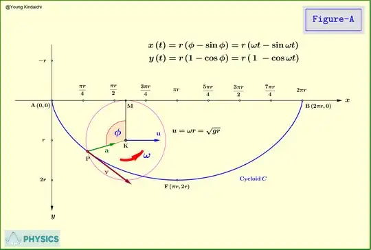

Recalling the statement of the problem :
Given two points A and B in a vertical plane, what is the curve traced out by a point acted on only by gravity, which starts at A and reaches B in the shortest time.
And as we can show with the method of variational calculus that the curve is turn out to be cycloid (Figure-A).
$$x=r(\phi-\sin\phi)$$ $$y=r(1-\cos\phi)$$
where $\phi$ is a real parameter, corresponding to the angle through which the rolling circle has rotated. For given $\phi$, the circle's center lies at $(x, y) = (r\phi, r)$
In the brachistochrone problem, the motion of the body is given by the time evolution of the parameter: $$\phi(t)=\omega t, \ \ \omega =\sqrt{\frac{g}{r}}$$

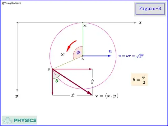

Now, look at the angle, call $\theta$, that the velocity vector makes with the vertical (Figure-B).
$$\tan(\theta)=\frac{\dot{x}}{\dot{y}}=\tan\frac{\phi}{2}$$ or $$\theta \propto t$$
In other words, In the $\theta-t$ plane, the curve is just a straight line. So What's the intuitive reason that the curve which minimizes the time should be a straight line curve in the $\theta-t$ plane?

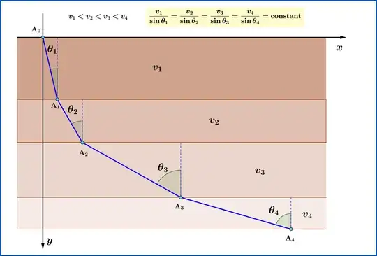

If we want a proof that time minimisation leads to the cycloid curve without using the Euler-Lagrange formalism then we must make use of the elementary proof of Snell's Law due to Feynman and given in my answer here : Why one should follow Snell's law for shortest time?. The proof doesn't use even differential calculus !!!
First note that the Euler-Lagrange formalism gives the result \begin{equation} y\left[1+\left(\dfrac{\mathrm d y}{\mathrm d x}\right)^{2}\right]=D=\texttt{constant}\:, \quad D>0 \tag{02}\label{02} \end{equation} and this leads to the cycloid curve (with $r=D/2$).
Exactly this constant of the motion is derived from the analogy of the refraction of light in a medium of variable refractive index (in other terms by connection with Snell's Law of refraction).
In the Figure below we see the path of least time from point $\:\mathrm{A}_{0}\:$ to point $\:\mathrm{A}_{4}\:$ through 4 regions of variable speed, increasing towards positive $\:y$. This would be the light path with decreasing refraction index. Under the assumption of least time path $\:\mathrm{A}_{0}\mathrm{A}_{4}\:$ every intermediate path $\:\mathrm{A}_{j}\mathrm{A}_{j+2}\,(j=0,1,2)\:$ is a path of least time between points $\:\mathrm{A}_{j}\:$ and $\:\mathrm{A}_{j+2}\:$. So, \begin{equation} \dfrac{v_{1}}{\sin\theta_1}=\dfrac{v_{2}}{\sin\theta_2}=\dfrac{v_{3}}{\sin\theta_3}=\dfrac{v_{4}}{\sin\theta_4}=\textrm{constant} \tag{03}\label{03} \end{equation} Now, if instead of the discrete regions we have a continuum with speed $\:v(y)\:$ being a continuous smooth increasing function of $\:y\:$, then in place of the piece-wise rectilinear path we would have a continuous smooth curve and \begin{equation} \dfrac{v(y)}{\sin\theta}=v(y)\sqrt{1+\tan^{2}\theta}=v(y)\sqrt{1+\left(\dfrac{\mathrm{d} y}{\mathrm{d} x}\right)^{2}}=v(y)\sqrt{1+y'^{\,2}}=\textrm{constant} \tag{04}\label{04} \end{equation} In the case of brachistochrone $\:v(y)=\sqrt{2g\,y}\:$ so above equation yields \begin{equation} \sqrt{y\left(1+y'^{\,2}\right)}=\textrm{constant} \tag{05}\label{05} \end{equation} and squaring equation \eqref{02}.
It seems that equation \eqref{01} is a result and not a starting point.

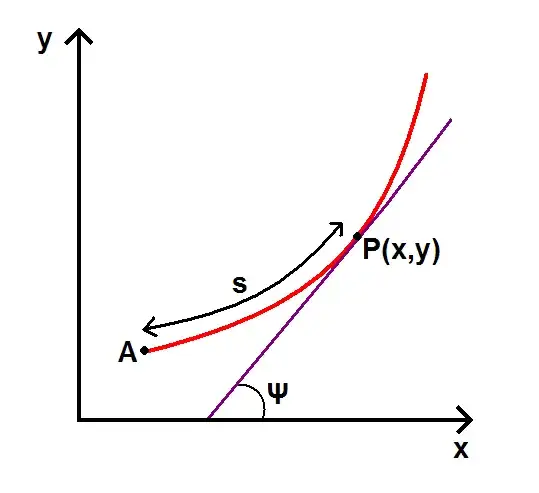

In any curvilinear coordinate system , a curve is described by specifying the values of the coordinates as functions of each other e.g. $y=f(x)$, or as a functions of some parameter, e.g. $y=y(t), x=x(t)$. Here, each coordinate is understood to be defined relative to some 'grid'. An alternative, and somewhat esoteric, way to describe a curve is to specify its arc length, $s$, and its angle of inclination (relative to some chosen direction in space), $\psi$. This does not require reference to any fixed grid of coordinates, and instead uses the 'intrinsic' properties of the curve itself.
Intrinsic coordinates
(N.B. this image shows the y axis pointing up - we will take it to be pointing down instead.)

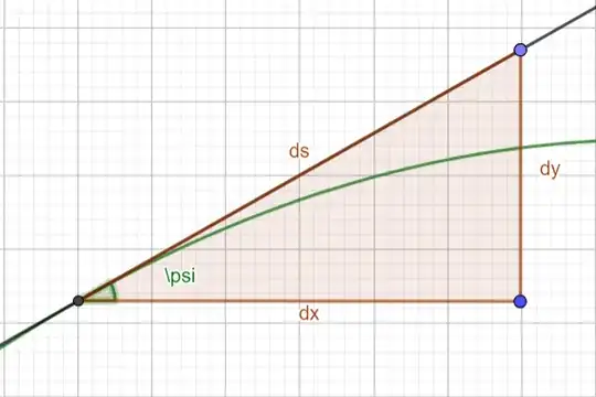

Cartesian coordinates and intrinsic coordinates are related by $$ \frac{\text{d}y}{\text{d}s} = \sin\psi, \qquad \frac{\text{d}x}{\text{d}s} = \cos\psi $$ These awkward equations are part of the reason that intrinsic coordinates are so rarely used. enter image description here
(I haven't quite figured out Geogebra yet!)
As you have seen, for a cycloid described by parametric equations $$ x(\phi) = r(\phi-\sin\phi), \qquad y(\phi) = r(1-\cos\phi) $$ we get $$ x' = r(1-\cos\phi), \qquad y' = r\sin\phi $$ so that $$ \frac{\text{d}y}{\text{d}\phi} \frac{\text{d}\phi}{\text{d}x}=\frac{r\sin\phi}{r(1-\cos\phi)} = \cot\frac{\phi}{2}= \frac{\text{d}y}{\text{d}s}\frac{\text{d}s}{\text{d}x} = \tan\psi \implies \psi = \frac{\pi}{2}-\frac{\phi}{2}. $$ We also have $$ s(\phi) = \int_0^\phi \text{d}\phi'\sqrt{x'^2+y'^2} = r^2\int_0^\phi \text{d}\phi' \sqrt{2-2\cos\phi'}=4r-2r\sqrt{2}\sqrt{1-\cos\phi}\cot\frac{\phi}{2}. $$ so that, combining the two, we get the very simple $$ s(\psi) = 4r(1-\sin\psi). $$ This is the first part done - we have used intrinsic coordinates to show how such a simple expression arises. I will now demonstrate why it is so simple in these coordinates.
