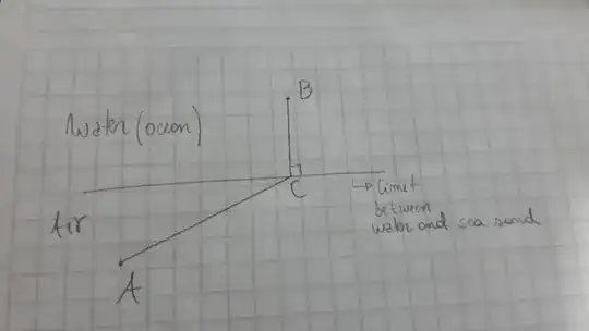

Since the shortest distance in the water must be traveled, we draw a perpendicular from the point in the sea (let's call this point $B$) to the limit between the sea and the sand (let's call this point $C$). Then a line is drawn from the point in the sand (let's call this point $A$) to the same point $C$. As drawn in this diagram:

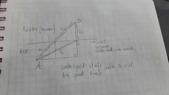

My idea will be to look for the necessary conditions, so that traveling in a straight line is faster than traveling as indicated by the Feynman analogy.
I create some segments, where $e_1, e_2, f_1, f_2$ are distances in meters.
The speed in the water is $W$ m/s and in the air is $A$ m/s, where the speed in the air is higher than the speed in the water, i.e $A > W$.
In addition to properties of triangles, we can establish certain inequalities between the distances created.
$f_1 > e_1$ and $f_2 < e_2$
We can say that if the time it takes for Feynman's analogy is longer than the time it takes for my counterexample, then my counterexample is faster.
Feynman's analogy time: $\frac{f_1}{A} + \frac{f_2}{W} = \frac{f_1 \cdot W + f_2 \cdot A}{AW}$ seconds.
Counter example time: $\frac{e_1}{A} + \frac{e_2}{W} = \frac{e_1 \cdot W + e_2 \cdot A}{AW}$ seconds.
So i need that, $f_1 \cdot W + f_2 \cdot A > e_1 \cdot W + e_2 \cdot A$.
Since $f_1 > e_1$ i can write $f_1 = e_1 + c$ with $c$ some positive number.
Since $f_2 < e_2$ i can write $f_2 = e_2 - q$ with $q$ some positive number.
replacing in the inequality $(e_1 + c) \cdot W + (e_2 -g) \cdot A > e_1 \cdot W + e_2 \cdot A$.
To get: $c\cdot W > g \cdot A$
So, the analogy does not work when this inequality is fulfilled.
Some example, $e_1 = 12, e_2 = 13, f_1 = 24, f_2 = 11, A = 3, W = 2$

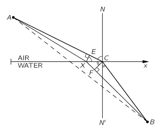

Your first drawing (minimizing the distance traveled in the water) is not what Feynman is suggesting. The path that actually minimizes the travel time between the two points has you enter the water at a point between your point C and the point where your straight line path enters. I refer you to the following figure taken from the Feynman lectures. (Vol I, Chapter 26)
It is a straightforward exercise in calculus to make the point where you enter the water arbitrary and then minimize the travel time to find the optimal path. You will then have derived Snell's law from Fermat's principle.
