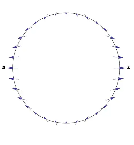

The tidal force
The tidal acceleration due to the Moon depicted at points on a great circle of the Earth. The tidal acceleration at a point on the surface is the vector difference between the gravitational acceleration at that point toward the Moon and the gravitational acceleration of the Earth toward the Moon. This points outward at the sub-Moon point and its antipode, but inward with half the magnitude where the Moon is on the horizon.
Source: https://physics.mercer.edu/hpage/tidal%20asymmetry/asymmetry.html
This is what Newton did get right. The tidal force is away from the center of the Earth when the Moon (or Sun) is at zenith or nadir, inward when the Moon (or Sun) is on the horizon. The vertical component is the driving force behind the response of the Earth as a whole to these tidal forces. This question isn't about the Earth tides. The question is about the oceanic tides, and there it's the horizontal component that is the driving force.

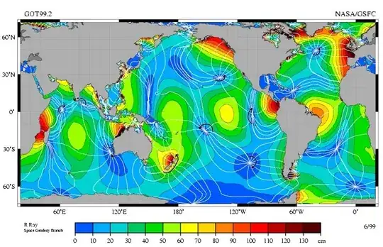

The global M2 tidal response
The response to the tidal forcing function comprise a number of different frequencies. The component with the largest response, by more than a factor of two, is the semidiurnal lunar tide, designated as "M2" by George Darwin. This image uses colors to depict the amplitude of the M2 tidal response around the globe. Key features are the amphidromic points, places where the M2 component is zero, the cotidal lines that emanate from these amphidromic points, and the directions in which these cotidal lines rotate about the amphidromic points.
Source: https://en.wikipedia.org/wiki/File:M2_tidal_constituent.jpg

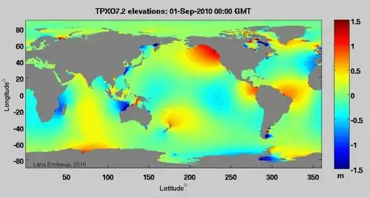

Animated GIF that depicts ocean elevations over the course of one day, as measured from space by the TOPEX/Poseidon radar altimeter. Since the M2 component of the tides dominates, the responses as seen in this image in most places show two high tides per day.
Source: http://volkov.oce.orst.edu/tides/global.html[broken link, not archived]
The M2 constituent of the tides is the roughly twice per day response to the tidal forcing function that results from the Moon. This is the dominant component of the tides in many parts of the world. The first image shows the M2 amphidromic points, points where there is no M2 component of the tides. Even though these points have zero response to this component, these amphidromic points are nonetheless critical in modeling the tidal response. The second image, an animated gif, shows the response over time.

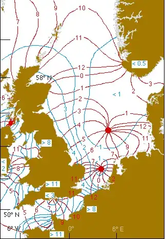

The M2 tidal response in the North Sea
Tides in the North Sea are crazy! There are two amphidromic points in the North Sea, and plus a partial amphidromic point near the tip of Norway. The image depicts the cotidal lines in red and lines of equal amplitude in blue.
Archived source: www.geog.ucsb.edu/~dylan/ocean.html

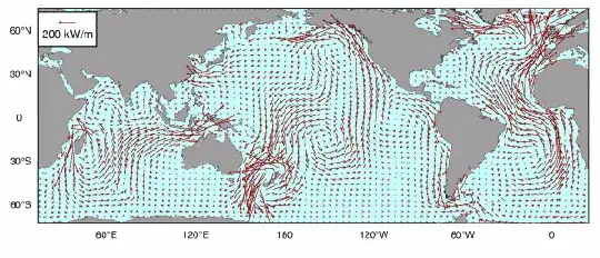

Energy flow of the semi-diurnal, lunar tidal wave (M2)
Image that depicts the energy flow of the M2 tidal component. See text below.
Archived source: www.altimetry.info/thematic-use-cases/ocean-applications/tides/ (www.altimetry.info/wp-content/uploads/2015/06/flux_energie.gif)
The above image displays transfer of energy from places where tidal energy is created to places where it is dissipated. This energy transfer explains the weird tides in Patagonia, one of the places on the Earth where tides are highest and most counterintuitive. Those Patagonian tides are largely a result of energy transfer from the Pacific to the Atlantic. It also shows the huge transfer of energy to the North Atlantic, which is where 40% of the M2 tidal dissipation occurs.
Note that this energy transfer is generally eastward. You can think of this as a representing "net tidal bulge." Or not. I prefer "or not."

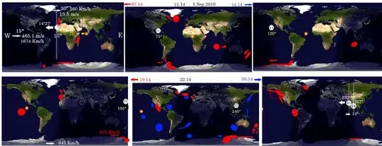

The theory of tides and transfer of angular momentum to the moon is false.
The explanation of the tides given by wikipedia and its fans, is false and it's a shame that such misleading pictures have not been removed, and are still quoted. In reality there is no bulge in correspondence of the moon at any time.

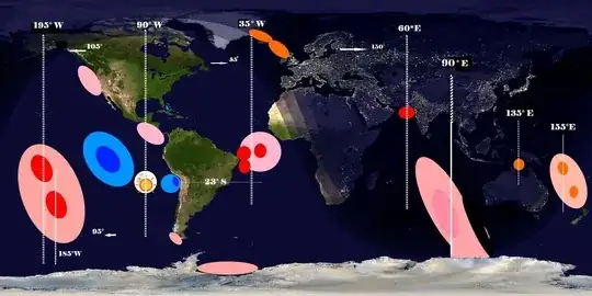

I took the trouble to get the positions of the moon (and the Sun) on the date shown in the quoted gif picture:
enter image description here enter image description here ( you can check here).
The red spots are the points of max elevation, the blue ones are the point with null elevation, whereas in the original gif they indicate depressions.
You can easily see that there is never a bulge in correspondence of the moon or ahead of it (which is the alleged reason for the acceleration of the moon inits orbit), actually you should note that the difference in the gravity pull where the moon is at the zenith is only a fraction of milliGal, and you can evaluate what it means if you consider that g pull on different places ot the earth can differ by 50mGals (due to latitude, altitude etc).
There can be no bulge when (for most part of the day) it is over land, and even when it is on the oceans there is no bulge: the elevations swifly rotate to the North guided by the amphidromic points and by the coastlines.
There is only on bulge that closely follows the moon and that is at the Antarctica, This happens because there are no obstacles on its way and because (due to latitude) the tangential speed of the earth equates the phase of the wave.
Picture 1 and 4 (one above the other onthe left) are taken with a 12-hour delay and show the only place where there are 2 tides (on that day), and the antipodal tide takes place between the sun and the moon. In order to get a clearer picture we may also look at the tides on a date (2000-1-6 18:00) when there is the highest possible tide: moon at perigee (Jan 6), a new moon (at 90°W), moon at the Tropic of Capricorn, on the oceans most of the day:
The data of the elevations are taken from this animation at 1:00. I have not been able to upload the frozen frame of 2000-1-6 18:00, if someone is able, please add the picture to make the verification more easy.
Unless someone can show I have mis represented those data, you can easily see that all the statements at wiki or in the other answer here and in similar question are proven false, ungrounded, unreal.
All myths around the bulges are busted: on both sides of the moon there are only depressions, no chance of equivocation, nothing thac can speed up the moon in its orbit (actually it is the other way round,the depressions can only decelerate it), there is no antipodal tide (at 90° E), and highs occur at unpredicted and unpredicatable places as you can see from the picture.
