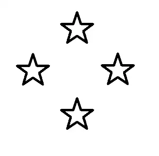

Let's say you have four stars arranged in the shape of a circle.

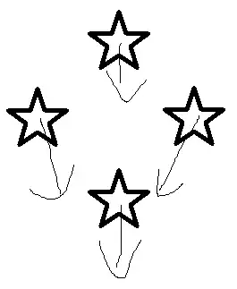

Now add the gravitational force due to a distant object directly below this setup. We can calculate the forces acting on each of these stars using $F = GMm/r^2$. We get something that looks like this:
The bottom star experiences the largest force. The two stars on the side experience a force that does not point straight down, but rather at the gravitating object directly.

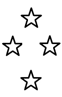

Because the forces & their directions are different, after a short while, the original circle is no longer a circle, but looks like this:

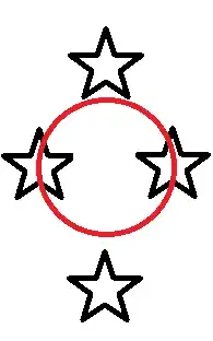

Now we'll add a circle to this diagram.
The circle corresponds to the surface of the Earth, while the stars correspond to the local water level. Note the star closest to the gravitating object (the Moon) is well displaced above the circle. This implies high tide. Similarly, note the topmost star is also well displaced above the circle, which also implies high tide. That is why there is a second bulge.
