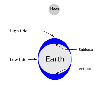

The effect of earth's gravity is not disregarded. It is what keeps the earth in one piece and approximately spherical. This is the dominant effect in the the earth's vicinity. Without it the sun and the moon would most likely stretch and tear it apart, as would earth's own rotation. Tides are a tiny perturbation on top of this effect caused primarily by the moon but also a little by the sun. That is why only the effects of the moon and possibly the sun need to be considered explicitly.
The gravitational field of the moon is almost uniform in across the earth's immediate vicinity. However, a completely uniform field could not cause tides since it would act identically on every particle: it would pull equally on the solid earth and oceans at all points. Einstein's equivalence principle says that an observer in free fall cannot physically even detect the presence of the uniform gravitational field. It is therefore only the non-uniformity of the field that actually causes tides.
It then makes sense to subtract out the uniform component and only consider the non-uniform deviations. The moon's field is strongest at the point nearest the moon and weakest at the antipodal point. It also has a component towards the line connecting the centres of the two bodies at points that do not lie on that line, because all lines of force converge to the moons center. Therefore the nemaining non-uniform part of the field pulls away from the center of the earth along the earth-moon line, but pushes toward it in the plane perpendicular to the line. The nett effect is to make the earth slightly football/cigar/prolate-ellipsoid shaped.
This has a far more pronounced effect on the oceans than on the solid earth, since water is a low viscosity liquid. This is what tides are.
If it were not for the earth gravitational field, these effects would make the earth really cigar shaped and eventually break it up since it is not a single rigid body, but more of a pile of rocks wrapped around a viscous core. Friction and viscosity would slow this process down but would not provide restorative forces. Also the oceans would shear off the earth completely.
The sun comes into play when considering spring tides and neap tides. The sun has qualitatively the same kind of effect on the earth as the moon but much weaker. It is still strong enough to modulate the effects of the moon:
  • High tides close to noon or midnight and low tides close to sunrise or sunset (spring tides) are more pronounced since the tidal forces from the sun and the moon reinforce each other, ie both are stretching the earth along the same line.
  • High tides close to sunrise or sunset and low tides close to noon or midnight (neap tides) are less pronounced since the sun and the moon are stretching the earth in orthogonal directions, which tends to cancel out. The moon still dominates but its effect is reduced.
A very good explanation of the ins and outs of tides is https://www.lhup.edu/~dsimanek/scenario/tides.htm That is where the above diagram is from.

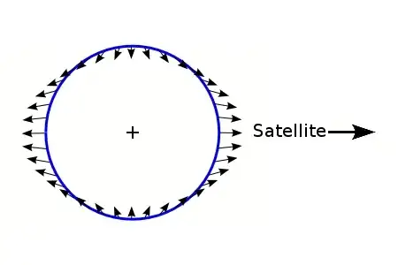

Let me summarize the different accelerations here:
  1. Acceleration of Earth's gravity. This is very important, it points "down" in your coordinates no matter where you are on the Earth, and it keeps the oceans on the planet, so that they roughly describe a round distribution around the Earth.
  2. Acceleration of the Moon's gravity on the center of the Earth. This is much less important. It always points towards the Moon, and it means that the Earth-Moon system does not rotate precisely around the center of the Earth, but instead at a point that's about 73% of the way from the Earth's center to its surface. This point is called the "Earth-Moon barycenter" and it does not directly affect the motion of the Earth's oceans because we're corotating with the force that's rotating us; the centripetal force that's on us balances out with the centrifugal force created by the rotation.
  3. The difference in strength of the Moon's gravity on the other points of the Earth. This is called the "tidal force." It has that name by definition. But it has an important effect because it causes the tides.
  4. Acceleration of the Sun's gravity on the center of the Earth. Obviously, this lets us orbit the Sun.
  5. The solar tidal force, analogous to the lunar tidal force.
The Earth's attraction of different parts of the Earth is roughly the same if you do not care about the equatorial bulge: Everest is only 9 km high on a 6370 km-radius planet, so that's only an 0.14% deviation from roundness -- and oceans don't even go that high; no tidal waves are lapping Everest. There are no substantial deviations in the Earth's attraction of its different parts.
The tidal bulges are caused because the an object's (Moon or Sun) acceleration of the different parts of the Earth are not the same. These do not go like $a = G m_{\text{object}} / D^2$ where D is the distance between the objects; that is how they accelerate the center of the Earth. Instead, D is bigger or smaller across the radius of the Earth; these differences go approximately like $2 G m_{\text{object}} R / D^3$ where R is the radius of the Earth and D is the distance between the centers.
Because of this, even though the Sun's gravitational force is much stronger than the Moon's, its tidal force turns out to be about half the strength -- it is just that much further away that the extra power of D tips the balance in the Moon's favor.
These tides create two bulges: on the close side, because there the Moon pulls the oceans more than it pulls the center of the Earth, but also on the far side, because there the Moon pulls the oceans less than it pulls the center of the Earth, so they "fall away" from the Moon a little bit -- alternatively you could say that we "pull the Earth out from under them."
Anyway, when the Moon is new, you get the strongest tides, when the Moon is full, you get the second-strongest tides, as the tidal effects directly or indirectly reinforce each other; when the moon is halfway waxing or waning, you see the weakest tides, as they cancel each other out.
