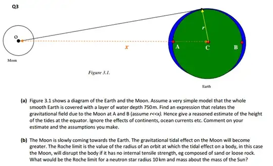

I am considering the following question, but I can't quite figure it out...
Enter image description here
I have looked up differential gravity, but I cannot derive the equation for the effect on Earth, and I haven't found any good links for it. I have seen this question, but it doesn't seem to derive the forces on different parts of the Earth, or how the force variation affects the water. I initially tried to consider the component of the gravitational force of the Moon acting normally to the Earth's surface. This would be $F = F_0 \cos(\theta)$ where $\theta$ is the angle between a horizontal line going through $A$ and $B$ and the point on the Earth's surface in question. But now I am stuck. I wanted to deal with forces rather than equipotentials, as it seems like that is what the question wants because of the 'hence'...
How do I start with any method, be it equipotentials or forces?

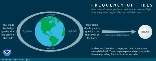

I'll start with an overly simplistic view of the tides. Suppose that the Moon was in a geosynchronous orbit and that the Earth was completely covered by water. In that case, the Earth's oceans would adjust themselves to form an equilibrium tide, first proposed by Newton, in which the surface of the oceans form an equipotential surface. The equilibrium tide is depicted below.
One of very many images that depict two tidal bulges, one on the side of the Earth nearest to the Moon and the other on the side furthest from the Moon.
Image source: http://oceanservice.noaa.gov/facts/tidefrequency.html
I chose this image because unlike most, it does not invoke centrifugal force to explain the bulge opposite the Moon. The near side bulge, if it existed, results from the gravitational acceleration toward the Moon on the point on the Earth closest to the Moon being slightly stronger than the action on the Earth as a whole, while the far side bulge results from the gravitational acceleration there being slightly less than the action on the Earth as a whole.
A number of things prevent that equilibrium tide from existing: The Moon is not in a geosynchronous orbit, the Earth is not completely covered by water, a month is much longer than is a day, and others. The equilibrium tide, aka the tidal bulges, does not exist. This means the Earth's oceans are perpetually in a state of disequilibrium with respect to the forces that generate the tides.

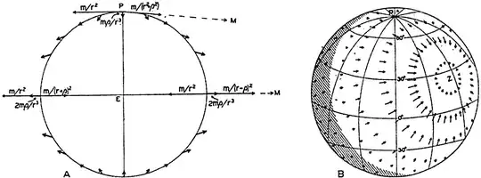

To arrive a better view of those forces, I'll look at things from the perspective of a reference frame with its origin at the center of the Earth. From the perspective of this frame, the gravitational acceleration at a point on the Earth's surface toward the Moon is the vector difference between the gravitational acceleration at that point toward the Moon and the gravitational acceleration of the Earth as a whole toward the Moon. This is depicted in the left half of the below image.
Two images that depict the gravitational source of the tides. The left image depicts the tidal acceleration due to the Moon at points on a great circle of the Earth with the Moon far to the right (not shown). The tidal acceleration at a point on the surface is the vector difference between the gravitational acceleration at that point toward the Moon and the gravitational acceleration of the Earth toward the Moon. This points outward at the sub-Moon point and its antipode, but inward with half the magnitude where the Moon is on the horizon. The right image portrays the horizontal component of this acceleration.
Image source: GH Darwin, "The tides and kindred phenomena in the solar system, 3rd ed.", Houghton, Mifflin (1911), via HU Sverdrup, MW Johnson, and RH Fleming, "The Oceans: Their Physics, Chemistry, and General Biology, Vol. 7." Prentice-Hall (1942) at http://publishing.cdlib.org/ucpressebooks/view?docId=kt167nb66r;brand=eschol.
Note that this force has both vertical and horizontal components. The vertical component of this force has a negligible effect on the Earth's oceans. The horizontal component however has a significant effect. This is what drives the tides in the oceans. The horizontal component this force, the tide-generating force, is depicted in the right half of the above image. (Note that a similar effect arises from the Sun, which also raises tides, but to a lesser extent. The tides raised by the Sun are a bit less than half those raised by the Moon.)

Consider an arbitrary point P and a point close to it, let's say A.
$\underline{g}_P = -\frac{GM}{r^2}$
Whereas $\underline{g}_A = -\frac{GM}{(r+a)^2}$
Taylor expansion on $\underline{g}_A = -\frac{GM}{(r)^2}(1-\frac{2a}{r} +...)$
Finding the difference between $\underline{g}_P$ and $\underline{g}_A$ yields $\frac{2aGM}{r^3}$
note that this answer obtained was due to a difference in the distance from the moon of $a$. Per unit distance, this would in fact be $\frac{2GM}{r^3}$.
If we also consider the centrifugal force, which turns out to be $\frac{\frac{GM}{r^2}}{r} = \frac{GM}{r^3}$ , we get a total of $\frac{3GM}{r^3}$ for the radial bulge outwards.
I am hoping I didn't give away too much. (and a quick tip: if in doubt, TAYLOR EXPAND!!)
