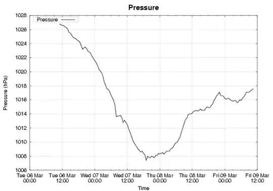

See for example this graph from the Australian weather service showing pressure changes over four days. The units on the left are $\mathrm{hPa}$ – you expect tidal variations to be much smaller. It may take a while (many cycles) to pick out the lunar variations - although I am sure it has been done.

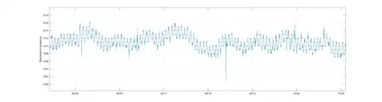

This isn't really an answer, and I will take it down shortly, just want to put it here as a demonstration of the clear dominance of the 12-hour constituent in the atmospheric tides in the tropics (can't put images in comments). The pressure record comes from last year in the Eastern tropical Pacific. There's a fair amount of variability on weekly timescales, and the 12-hour oscillation stands out, but you can't really make out a 24-hour component at all.
So even though the tides are driven by solar heating, which certainly sounds like it would mean they'd follow a daily cycle, they actually have a half-day cycle.
