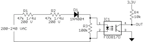

To figure the parameters of the circuit, start with what you need at the output and work backwards. 10 kΩ is a good value for the pullup on the output. Unless you have unusual requirements, like battery operation where low power is important, 10 kΩ is a good tradeoff between low enough to pull the line solidly high against leakage and reasonable noise, but not so low as to require too much current.
When the output transistor in the opto turns on, it will put at most 3.3 V accross Rc. 3.3 V / 10 kΩ = 330 µA, which is the minimum current the transistor must be able to sink. You want some extra so that the line is held solidly low when it is supposed to be low. I'd say at minimum it should be able to sink 500 µA, but I'd use 1 mA unless you have a particular reason to cut it close.
Now that we know that the output has to sink 1 mA, we look in the datasheet of the opto to see how we need to drive it to get that 1 mA out. You are using the "-3" variant of this part, which according to the first page of the datasheet has a minimum guaranteed current transfer ratio of 100%. That means that the transistor can sink at least as much current as you put thru one of the LEDs. However, note the little "±10 mA" above the CTR specs. What this is really saying is that if you put 10 mA thru the LEDs, then the transistor will be able to sink at least 10 mA. It doesn't actually promise anything at any other input current.
Looking thru the datasheet more, you find additional information at the top of page 3. Here they actually show the CTR for 1 mA input. Note that now it's only guaranteed to be 34%. That means to get the 1 mA output sink capability, you have to drive the LEDs with 1 mA / 34% = 2.9 mA, so let's aim for 3 mA absolute minimum.
You say the voltage that has to be sensed is 230 V AC. Since that is a sine, it will have peaks of 325 V. The output signal of the opto is going into a micro, so there is no need for it to be a steady signal when power is on. In fact, it's a good idea for the micro to be able to ride out momentary interruptions and glitches. I'd probably keep a counter that is decremented every ms when the signal is off and reset to something like 50 when on. That means you have to see no signal for 50 ms to declare that power is off. All that is needed is a little blip at the peak of the line cycle and this system will work fine. Note that line cycle peaks occur every 10 ms with 50 Hz power.
So let's see where we're at. We want to have at least 3 mA flow thru the LEDs when the power voltage is 325 V. The LEDs will drop up to 1.65 V (top of bottom table on page 2), and this should still work at the lowest reasonable power line voltage. Let's aim for being able to detect 200 VAC minimum, which is 283 V peak, and 281 V after the LED drop. 281 V / 3 mA = 94 kΩ. In theory, that's all that is needed in series with the LEDs to trigger the output at least a little bit once per power peak.
In practise it's a good idea to add some margin. You want the output to be asserted for a reasonable finite fraction of each half-cycle, not just guaranteed to be on for a little blip. Given all that, I'd roughly halve the resistor to 47 kΩ. That will solidly turn on the output for all reasonable conditions with significant margin.
You might think that's all you need to do, but wait, there's more. Think what will happen at high line voltage, like 240 V. The peaks are 340 V, which would cause 7.2 mA thru the LEDs. You have to check the maximum allowed LED current, which is 60 mA, so that's OK. However, consider the power dissipation in the resistor. If we say the worst case line voltage is 240 V, then the power going into the resistor (ignoring the LED voltage drop) is (240 V)2 / 47 kΩ = 1.23 W. That should be at least a "2 W" resistor then, and it will get noticeably warm.
Another issue is that the voltage rating of the resistor needs to be considered. It needs to be able to withstand the 340 V peaks, so overall you need a 47 kΩ resistor rated for 2 W and 400 V. Those can be found, but it might be simpler all around to use several resistors in series. That spreads out the peak voltage and the power dissipation among the series resistors. Four 12 kΩ resistor would do this and will only dissipate 300 mW and see 85 V each. That will be easier to find and cheaper than a single resistor unless this is a volume product where you can buy things in large quantity. So the answer to the question as asked is to put four ordinary 12 kΩ 1/2 Watt resistors in series with the LEDs.
Note that these don't need to be split up on each side of the opto as you show R1 and R2. There only needs to be a single resistance in series with the LEDs somewhere. Since this resistance happens to be made up of four individual resistors in this case, you can split them up any way you like to make things work out best mechanically on the high voltage side of the circuit. Preferably they would be end to end to maximize the creapage path for the high voltage and to spread out the heat.
However, I don't really like this optocoupler for this application since it has such low current transfer ratio, which forces us to provide a lot of LED current, which causes a lot of power to be consumed in the resistor. For this sort of application where high current transfer ratio is useful and speed doesn't matter much, I like the cheap and available FOD817. The D versions of this part have a guaranteed CTR of 3x at 5 mA. They don't say exactly what you get a 1 mA, but it's a pretty safe bet the output can sink at least 1 mA with 1 mA in.
The FOD817 has a single LED, but that is easy to deal with (The FOD814 has back to back LEDs, but is less available and doesn't come in some of the higher gain variants). Using the 50 ms scheme described above, it's no problem if you get a pulse once per line cycle, which is every 20 ms. Put a diode in series with the LED in addition to the resistors, and a high-value resistor accross the LED to make sure it doesn't see high reverse voltage due to a little bit of diode leakage. 100 kΩ is fine, and is high enough for its current to be irrelevant to our other calculations. Another advantage of this is that not only do you get lower power dissipation due to requiring less LED current, but you get another factor of two reduction in power due to the LED only being driven in one direction. A total series resistance of 100 kΩ or so will still give you plenty of current headroom at the power line peaks, but will dissipate less than 300 mW total due to the lower current and being on only half the time.
So here is my final answer:
