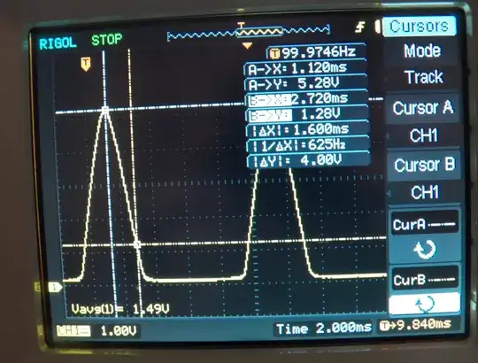

For a very lazy approach. Here's what i build and it worked. Can't pull DSO screenshots. Lazy :)
Though this did not disappoint me. It served my purpose. enter image description here

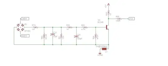

i have used this shematic and it works well.But you want to change resistor value. i have connected logic analyzer to collector and calculated for 220Vac.
