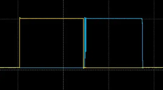

I've built the circuit and have included pictures of the output waveforms, yellow is voltage, current is blue. The AC ground 0 V and DC ground 0 V are separated in the physical build, that's why the ground references are different in the schematic.
When the circuit is connected as per the circuit diagram, the output square waves are as the output 1 picture. The voltage wave form is as expected but the current waveform is constant regardless of the current transformer output. It always has that pulse near the falling edge of the voltage waveform regardless of the load sensed through the current transformer/sensor.

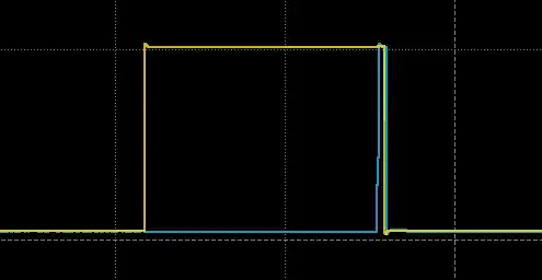

When I invert the current transformer inputs to the comparator, the waveform is as the output 2 picture. It seems to work right, but I think that I might have just inverted the waveform by 180° by putting the larger input into the inverting pin of the comparator.

  • Have you ever studied what the input current waveform is for a load connected via a bridge rectifier and smoothing capacitor? – Andy aka Nov 02 '22 at 12:19
  • You're powering the comparators from GREF2, but their negative inputs are ground. There is an AC voltage difference between these two. If you've already accounted for this, mentioning it and adding a 'scope showing ground minus GREF2 could be helpful for future readers. – rdtsc Nov 02 '22 at 12:30
  • AC ground is outside of your comparators' input common-mode voltage range. U7A is going to get killed if you ever physically build that circuit. – Jonathan S. Nov 02 '22 at 18:42
  • Ant.F; You may also want to review this EESE answer as it may be useful to consider it. – jonk Nov 02 '22 at 19:33
  • Sorry the late reply. I have checked the input waveform andy, the sine wave is as it was before the rectifier was added. Im aware of the common mode input range johnathon, the max the 393 can handle is -300mV and the input is max -140mV. I know the datasheet says 0V for normal conditions but this is what i had to work with, the voltage waveform is working normally. I will review that jomk, thanks. Thanks everyone for the replies – Ant.F Nov 02 '22 at 21:54
  • Add a simple voltage divider with 2 resistors to create 2.5 V and use this as virtual GND for the current transformer. This way you stay within the common mode voltage range of your comparator. – Jens Nov 02 '22 at 23:08
