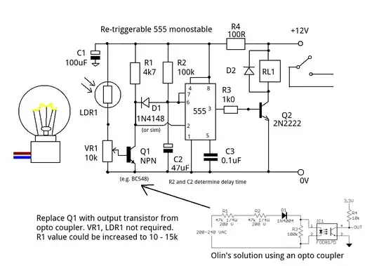

There are two basic ways to solve this problem.
(i) Either use the light from the bulb when it is switched on (e.g. using an LDR etc.)
or
(ii) Intercept the switch signal and electrically isolate as per FakeMoutache's suggestion using the circuit supplied by Olin in a previous question.
That still leaves the 12V circuit in the middle to switch on a relay and keep it on after the light turns off. i,e, a re-triggerable monostable. enter image description here
LDR1,VR1 and Q1 form an (isolated) light sensitive switch. When the lamp truns ON the resistance of LDR1 falls and Q1 switches ON triggering the monostable. D1 prevents C2 from charging so the output remains HIGH (relay tuned ON). Once dark Q1 is OFF, C2 charges and after a delay (R2,C2) the relay is turned OFF.
Q1, VR1 and LDR1 can be replaced by the opto coupler circuit.The monostable works exactly the same as before.
