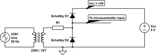

I'm personally planning to make a zero crossing detector using an old power adapter, one with a conventional transformer. This ensures absolute safety to the circuit. I plan to feed the low voltage output through couple of resistors and clipping diodes to a microcontroller and won't need a optocoupler.
For my application however the exact zero crossing isn't too critical as long as relative timing is stable. When using a transformer Wouter's comment about the phase shift will probably apply too. Notice that the circuit diagram below is not for supplying Vcc to the microcontroller. Vcc as marked in the diagram is the power supply already present for powering the rest of the circuit. It is here only used to clamp to.
schematic
