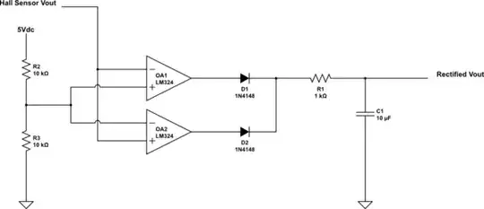

With a LM324 using two of its four Op Amps in comparator mode like in this schematic:
schematic
