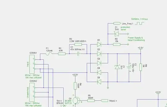

I needed a similar solution. I happened to also require 3.3V to power a microcontroller, through a non-isolated supply. In this case it provides a square wave at 50 or 60 Hz; a rising or falling edge signals a zero crossing point.
Danger of Death - Non-isolated power supply, trained people only.

  • I've opened a question to clarify what is meant by "trained" in this context: http://electronics.stackexchange.com/questions/8678/basic-training-for-working-with-120v-ac – Isaac Sutherland Jan 06 '11 at 23:20
  • Why did you use a non-isolated solution? – tyblu Jan 07 '11 at 07:39
  • @tyblu, Targetting a very low cost price range. In future I would probably use a non-isolated ViPER-12A or similar buck converter due to higher efficiency. – Thomas O Jan 07 '11 at 09:22
