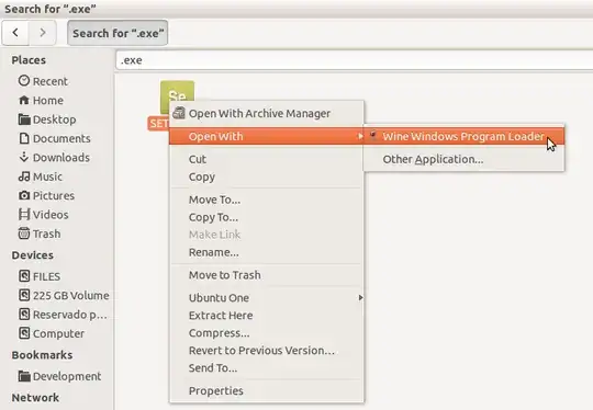

A .exe file is compatible with a Windows system, but this files are not compatible with Ubuntu. At least in a native way.
You can install WINE to install Windows programs. This is a software for running Windows applications in Linux platforms. I should mention that not every Windows program will run correctly with WINE. But you don't loose anything trying.
The apt command is not the way to install EXE files, the correct procedure is the following:
  1. Install Wine
  2. Open the exe file with Wine doing secondary click on the file and selecting Wine Windows Program Loader
Second_Click_On_EXE_file

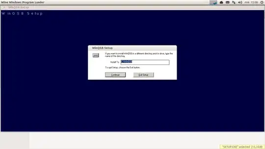

The rest depends on the setup method of the software. Example:
setup_method
