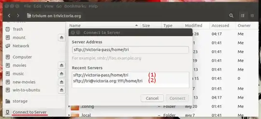

Using Nautilus
You can use the option Connect to Server in Nautilus as it is shown on the next image.
  1. The first example - sftp://victoria-pass/home/tri - uses predefined host called victoria-pass and mounts the home/ directory of the remote user called tri.
    To use this approach, you should create user's configuration file for the local ssh client. The file must be called config and placed in the directory .ssh/ in user's home: ~/.ssh/config. According to the example the content of the file should be:
    Host victoria-pass             # this is as 'nickname' of the connection
        HostName victoria.org      # or use the IP address
        IdentityFile ~/.ssh/id_rsa # or provide the fill path to another key
        User tri                   # use the actual name of the remote user
        Port 1111                  # provide the actual port of the remote server
        # other parameters...
    # setup each another Host in the same way...
    Change the file permissions:
    chmod 600 ~/.ssh/config
    In addition, now you should be able to connect to each of these hosts by a command as:
    ssh victoria-pass
  2. The second example - sftp://tri@victoria.org:1111/home/tri - shows how to connect to a remote ssh (sftp) server without using predefined ~/.ssh/config file with a custom ssh port.
    The main cons of this approach is that if the authentication file is not ~/.ssh/id_rsa you should provide it in advance by the command ssh-add. For example if the authentication file is called file.pem:
    ssh-add /full/path/to/the/authentication/file.pem
    I think you should do this every time when you restart the local machine, or you should include the above command in the ~/.profile file.

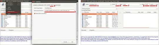

Usung gFTP
Here are the steps how to setup gFTP to use SSH keys.
  1. In the FTP menu click on Preferences;
  2. Go to SSH tab;
  3. Fill the field SSH Extra Params with this value:
    -o IdentityFile=/home/<your user>/.ssh/id_rsa
    Change <user name> with your real username. Or use:
    -o IdentityFile=~/.ssh/id_rsa
  4. In gFTP's main window choice SSH2 as type of the connection;
  5. Enter the target Host name, or IP address;
  6. Setup the SSH Port of the target machine (if it's not the default - 22);
  7. Enter User for the SSH connection;
  8. Enter your SSH key's Passphrase (if there is some);
  9. Hit Enter.
