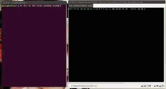

In the normal circumstances you will be able to access your remote Ubuntu server via SSH. For this purposes, on your desktop machine, you will use a terminal emulator as gnome-terminal (on Ubuntu) or PuTTY (on Windows), etc. So you will be able to do cat id_rsa.pub, then copy the content of the key from the terminal window in use and paste it in the Key field in your browser's window. Actually in this way you will use the clipboard of your (local) desktop system.
What you need is installed openssh-server on the remote instance and openssh-client on the local (desktop) instance. Use the following commands to do that:
sudo apt install openssh-server
sudo apt install openssh-client
Then you must have an IP address (or a domain name) of the remote instance, which you can access from the local instance, no mater directly, through VPN, SSH tunnel, etc. In your case you can use ifconfig to find the IP address of the Ubuntu Server in your LAN.
The basic syntax of the ssh command is:
ssh user@host     # where host IP address or domain name
You should execute that command within a terminal window on the local (desktop) system. Then you will be able to operate freely (depending on your user's rights) on the remote server with the pleasure of the GUI environment :)
