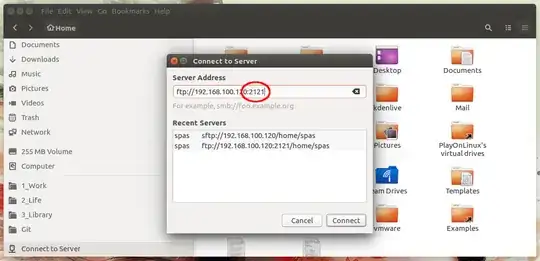

Another way to solve this issue is to change the port on which one of these services listen. For example you can do that for vsftpd by adding the following directive to /etc/vsftpd.conf - reference:
listen_port=2121
Then you should instruct the FTP client to connect via the port 2121 instead of the default one. In most cases you just need to add :<port-number> at the end of the target ip-address/FQDN. For example, if you are using Nautilus as FTP client:
