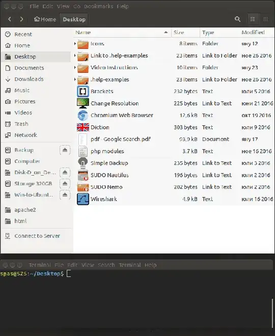

The location you are looking for is: /run/user/1000/gvfs. Or more precisely /run/user/$UID/gvfs. The approach that I've used to get this is shown on the following animation.
The approach, that I used to get path /run/user/1000/gvfs

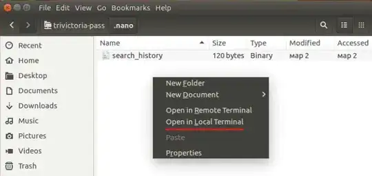

You can use also the option Open in Local Terminal from the context menu (right mouse button):
