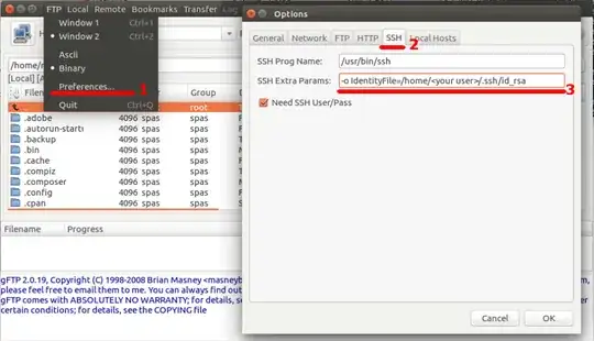

I ssh to a remote server from command line using key to not enter password at any time want to connect. I need to transfer some files to the server using gFTP software.
Is it possible to use ssh key to connect to a remote server via gFTP in Ubuntu?
Thank you.
Zanna
  • 72,312
hd.
  • 4,087
Here are the steps how to setup gFTP to use SSH keys:
  1. In the FTP menu click on Preferences;
  2. Go to SSH tab;
  3. Fill the field SSH Extra Params with this value:
    -o IdentityFile=/home/<your user>/.ssh/id_rsa
    Change <user name> with your real username. Or use:
    -o IdentityFile=~/.ssh/id_rsa

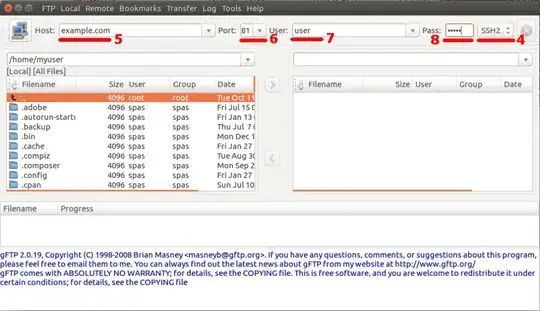

  4. In gFTP's main window choice SSH2 as type of the connection;
  5. Enter the target Host name, or IP address;
  6. Setup the SSH Port of the target machine (if it's not the default - 22);
  7. Enter User for the SSH connection;
  8. Enter your SSH key's Passphrase (if there is some);
  9. Hit Enter.
