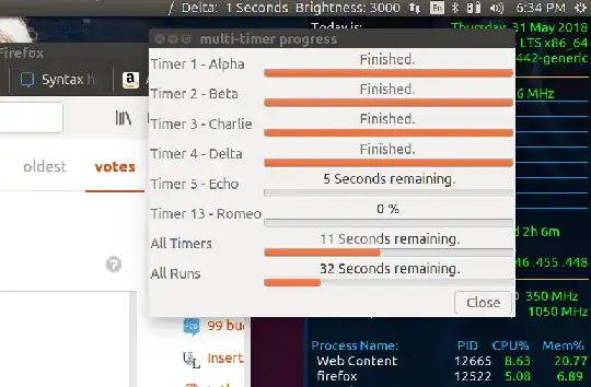

Sysmonitor Indicator in action
This .gif shows how it looks when Ubuntu’s Unity System Tray is updated.
- At the beginning of the animation the Systray output contains "Brightness: 3000". Note: As of July 6, 2020 the script was changed to display "eyesome: 99%" where 99 is the percentage of sunlight based on time of day. A link to
eyesomeis provided below. - Then
multi-timer(link below) is started and steps through multiple timers. - A spinning pizza appears along with a count down of time remaining for the current timer.
