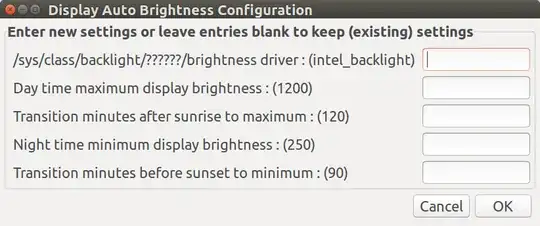

Configure brightness settings and transition time
You don't want your display to change to full brightness on sunrise and full dimness on sunset. A transition period is needed. Additionally a configuration file is required to record the variables for full brightness and full dim. This is the configuration screen:
display-auto-brightness-config
The screen is built using standard zenity command and as such existing values are shown in labels with "(value)" tag and you key in new values if needed. Otherwise the existing files are kept when new values are blank.
Replace intel_backlight with your display driver if different. To find out your name use: ls /sys/class/backlight/*/brightness.
Using sudo powers create the file /usr/local/bin/auto-brightness-config and paste in this code:
