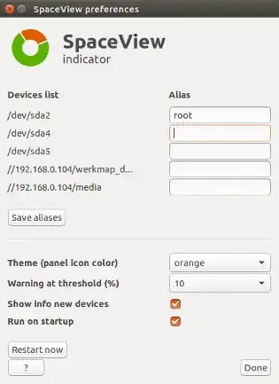

  • Setting all aliases in one window
  • Setting theme colors for the panel icon:
    enter image description hereenter image description hereenter image description hereenter image description here
  • Setting threshold for warnings
  • Show info on newly mounted / connected volumes in a notification:
  • Run on Startup
Furthermore, the indicator now includes a smaller (width) icon set for other distro's (like xfce), which will be automatically applied, depending on the window manager.

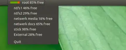

  • For one or more (or all) devices, you can set an alternative name ("custom name"), to be set in the head of the script
    As an example, this:
    alias = [
        ["sdc1", "stick"],
        ["sdb1", "External"],
        ["sda2", "root"],
        ["sda4", "ntfs1"],
        ["sda5", "ntfs2"],
        ["//192.168.0.104/media", "netwerk media"],
        ["//192.168.0.104/werkmap_documenten", "netwerk docs"],
    Will show:

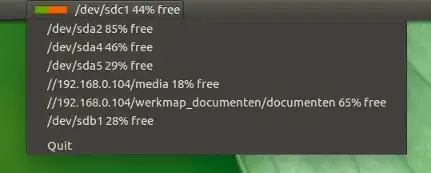

Setting up
Setting up is simple:
  • Copy the script into an empty file, save it as showusage.py
  • Save the icons above, exactly named as in their label, into one and the very same directory as the script (right- click > Save as)
  • In the headsection of the script, set (possible) alternative names (aliasses). Below an example:
    alias = [
        ["sda2", "root"],
    If you want to display the devices unchanged, use:
    alias = []
    ...and if you want, change the threshold to show a warning:
    #--- set the threshold to show a warning below (% free, in steps of 10%)
    #--- set to 0 to have no warning
    threshold = 10
    That's it
Running it
To use the indicator, run the command:
python3 /path/to/showusage.py

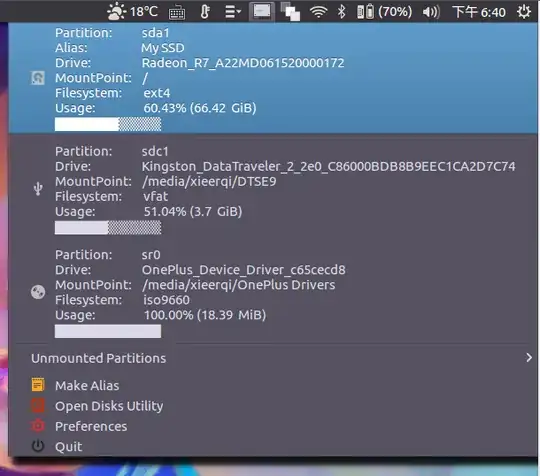

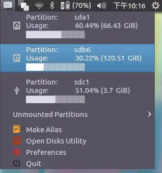

As mentioned in the release notes the features include:
  • Icons for menu entries: each partition/device has appropriate icon attached to it. If the device is usb disk , removable media icon is used, if it's iso image - the optical disk icon is used, and obviously hard drive/SSD partitions have drive icons.
  • Usage is now shown in percentage and human-readable values ( powers of 1024 ).
  • Graphical representation of usage via usage bar ( big thanks to Mateo Salta for the idea )
  • Preferences dialog : users can turn off certain fields that they do not want to see per each menu entry. This allows keeping indicator menu clean if there is a large amount of partitions attached. ( Thanks to Zacharee's request)
  • Text spacing: with default Ubuntu font and Monospace fonts, the text entries are nicely spaced to have cleaner look and enhance readability of the information.
  • Notification bubbles in case partition cannot be mounted
Below is the screenshot with default Ubuntu icon theme: enter image description here
Ubuntu Kylin icon theme
With all optional fields off

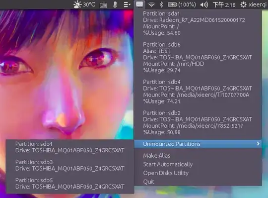

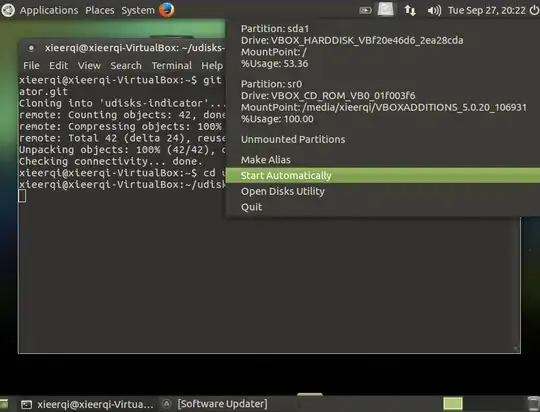

udisks-indicator (original answer)
Indicator for Ubuntu with Unity desktop to show disk usage Sample Screenshot
Overview
This indicator for Ubuntu with Unity allows easily view information about your mounted partitions. It strives to be visually similar to iStat Menu 3 menulet from OS X.
Entries are organized in order:
  • Partition
  • Alias ( if set by user )
  • Disk Drive to which partition belongs
  • Mountpoint of the partition ( directory )
  • % Usage
Clicking on each partition entry will open the partition's mountpoint in the default file manager
The "Unmounted Partitions" menu lists all the partitions not currently mounted by the system. Clicking on any entry in that submenu will mount that partition automatically, typically to /media/username/drive-id folder
The indicator uses default icons provided with the system, so the icon should be changing as you change the icon theme using Unity Tweak Tool or other methods
NOTE: if you want to add multiple aliases at the same time, instead of one by one via "Make Alias" option, you can do so via editing the ~/.partition_aliases.json configuration file. The format is as follows:
    "sda1": "Alias 1",
    "sda2": "Alias 2",
    "sdb1": "Alias 3"

install udisks-indicator-master/udisks-indicator /usr/bin/udisks-indicator
install udisks-indicator-master/udisks-indicator.desktop /usr/share/applications/udisks-indicator.desktop
Source code
Original source code (Version v1.0) with basic functionality of this indicator can be found below. For newest features , check GitHub repository for this project. Please report any feature requests as well as errors on GitHub.
The /usr/bin/udisks-indicator:
#!/usr/bin/env python3
# -*- coding: utf-8 -*-
# Author: Serg Kolo , contact: 1047481448@qq.com
# Date: September 27 , 2016
# Purpose: appindicator for displaying mounted filesystem usage
# Tested on: Ubuntu 16.04 LTS

Additional Info:
Ubuntu Mate 16.04 test:
Gnome users need an extension (KStatusNotifierItem/AppIndicator Support) to make the indicator behave properly:
Install Sysmonitor Indicator:
sudo add-apt-repository ppa:fossfreedom/indicator-sysmonitor
sudo apt-get update
sudo apt-get install indicator-sysmonitor
and it has "Available Space in File System" option.
