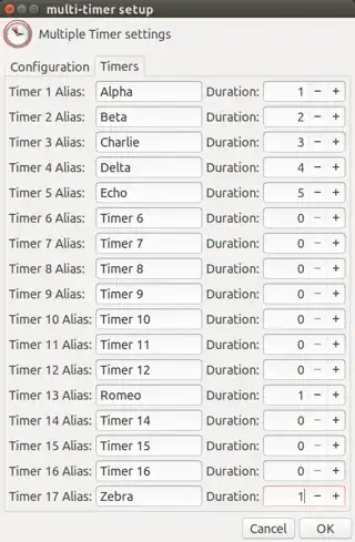

Notebook Timers Tab
The Timers Tab allows you to:
  • Define alias for each timer rather than Timer 1, Timer 2, etc.
  • Set the number of seconds or minutes each timer runs.

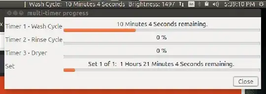

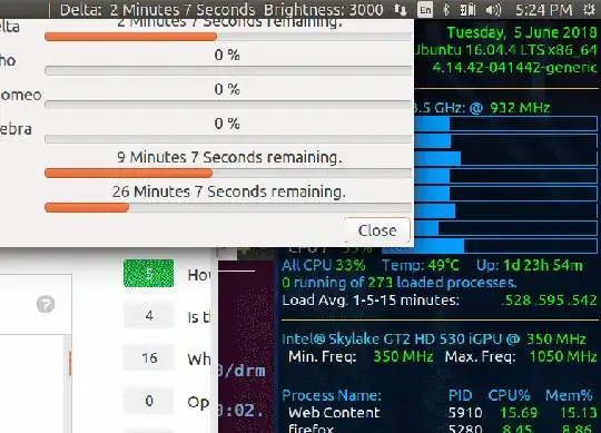

Progress Bar Display
As multi-timer counts down progress bars are used for:
  • each active timer (zero duration timers are not shown)
  • each set (if two or more active timers in set)
  • all sets (if two or more sets run)

Sysmonitor Indicator Interface
You can have the System Tray / Application Indicator Area update with the time remaining along with a "spinning text pizza" as illustrated in the GIF in above the bash listing.
To setup Sysmonitor Indicator see this Q&A: Can BASH display in systray as application indicator?
