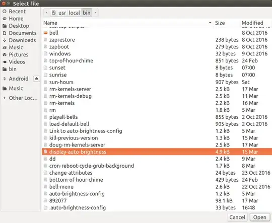

websync file input

Notice the "File name" field. When you enter it the file selection dialog box in the first section appears.
