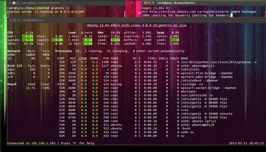

Basic usage
To start glances simply type glances in terminal.
screenshot
In glances you’ll see a lot of information about the resources of your system: CPU, Load, Memory, Swap Network, Disk I/O and Processes all in one page, by default the color code means:
GREEN : the statistic is “OK”
BLUE : the statistic is “CAREFUL” (to watch)
VIOLET : the statistic is “WARNING” (alert)
RED : the statistic is “CRITICAL” (critical)

Cpu , Ram , Swap Monitoring
screenshot
Disk Monitoring
screenshot

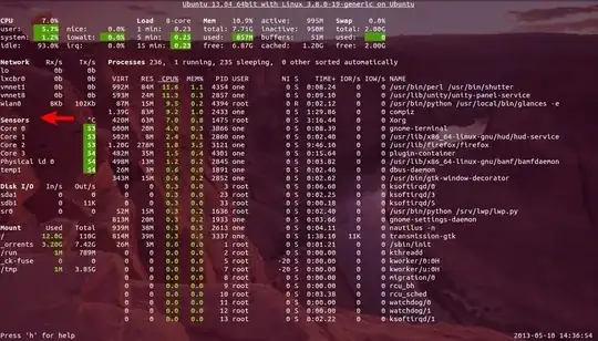

System Heat Monitoring
If you type glances --help you will find ( -e Enable the sensors module (Linux-only) )
glances -e
screenshot
screenshot

Monitoring juju container just for example how things look like Large Image
In terminal no 1 Glances is running in server mode, In terminal no 2 juju container is running apt-get update & In terminal 3 glances -c 192.168.1.103 Glances is connected to container ip
screenshot

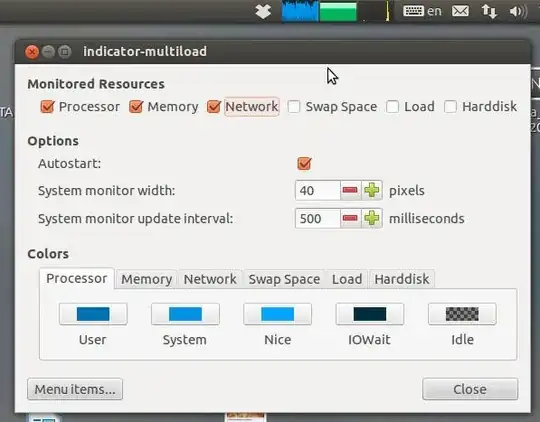

indicator-SysMonitor
Indicator-SysMonitor does a little, but does it well. Once installed and run, it displays CPU and RAM usage on your top panel. Simple.
Download from here

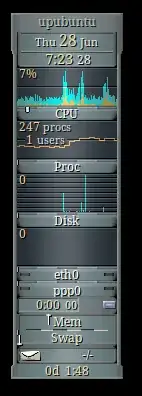

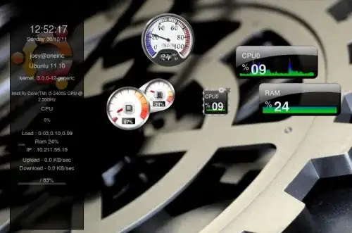

Conky
One of my personal favourites
Screenlet you’ll find a bunch of differently styled CPU and RAM monitors included in the screenlets-all package available in the Ubuntu Software Center.

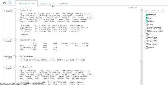

Following are the tools for monitoring a linux system
  1. System commands like top, free -m, vmstat, iostat, iotop, sar, netstat etc. Nothing comes near these linux utility when you are debugging a problem. These command give you a clear picture that is going inside your server
  2. SeaLion: Agent executes all the commands mentioned in #1 (also user defined) and outputs of these commands can be accessed in a beautiful web interface. This tool comes handy when you are debugging across hundreds of servers as installation is clear simple. And its FREE
  3. Nagios: It is the mother of all monitoring/alerting tools. It is very much customization but very much difficult to setup for beginners. There are sets of tools called nagios plugins that covers pretty much all important Linux metrics

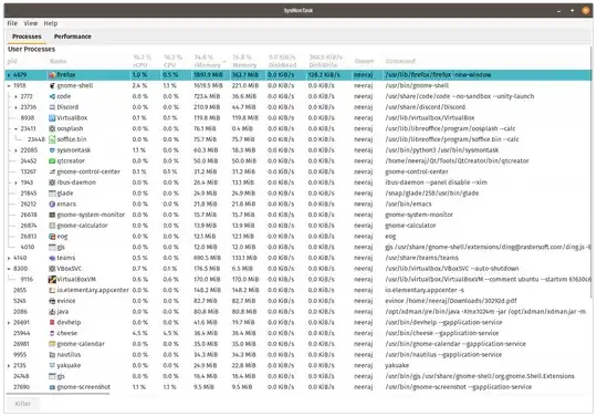

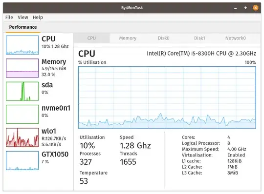

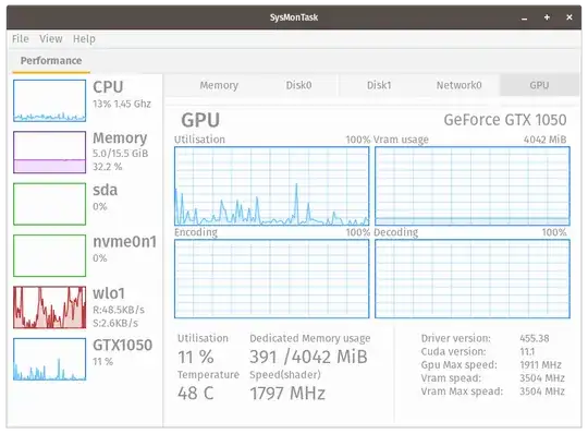

You might want to try sysmon. Although not as fancy as Glances, it is very straightforward and easy to use.

I was stunned to see when there is no simple,ellegant as well advance GUI System monitor like Windows TaskManager. KSysGaurd in KDE is great but requires plugins to install new functionality without it, is similar to gnome-system-monitor. KSysGaurd has advance options but not very simple. Personally, I didn't like either the KSysGaurd and Gnome-system-monitor.
I went and tried created a simple elegant GUI like Windows Task Manager. Check out my approach for the same: https://github.com/KrispyCamel4u/SysMonTask
Some highlights are: CPU performance Tab GPU performance Tab
Update: Now I have added the user Processes in version 1.1.0
I have filtered out the background Processes(with some exception) and shown only user-specific Processes (user parent and child process like in windows) which makes it easy to spot processes that you are interested in instead of finding out from the pool of all process that gnome-system-monitor shows.
Also, it includes the aggregates(on the column header) of all the processes.
process
There are only a few processes that are kinds of background but still appear: The exceptions :(
Suggestions are most welcomed in improving.

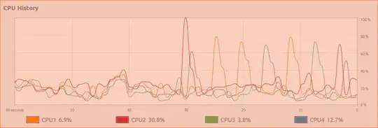

There is a built-in tool called gnome-system-monitor. It can do all of what you mentioned, except the heat monitoring.

I like to use conky which can be configured anyway you like:
You can google conky and find 787,000 hits. There is something for everyone.

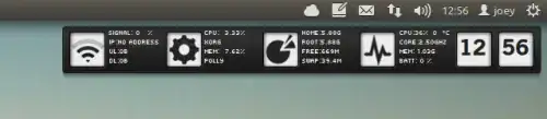

At the top of the display notice "Lock screen: 4 Minutes Brightness: 2074". These are generated by "Indicator-Sysmonitor" which allows you to display on the systray / application indicator using a bash script.
For a tutorial on setting up "Indicator-Sysmonitor" see: Can BASH display in systray as application indicator?
SeaLion can be handy tool as it has built-in commands to monitor your server performance as well as you can add your own custom commands, scirpts and log output. It's very easy to setup and find out what went wrong at specific time.

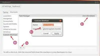

Used to be a Windows user? You may want an Ubuntu equivalent of the Windows Task Manager and open it via Ctrl+Alt+Del key combination.
Ubuntu has the built-in utility to monitor or kill system running processes which acts like the “Task Manager”, it’s called System Monitor.
Ctrl+Alt+Del shortcut key by default is used to bring up the log-out dialog on Ubuntu Unity Desktop. It is not useful for users who are used to quick access to the Task Manager.
To change the settings of the key, open Keyboard utility from the Unity Dash (or System Settings -> Keyboard).
On Shortcuts tab -> Custom Shortcuts, click the plus icon to add a shortcut. Type in name Task Manager and command gnome-system-monitor.
help
After it is added, click on where it says “Disable” and press Ctrl+Alt+Delete. You’ll get a dialog said “The shortcut key … is already used for Log Out”, click Reassign and you’re done!
